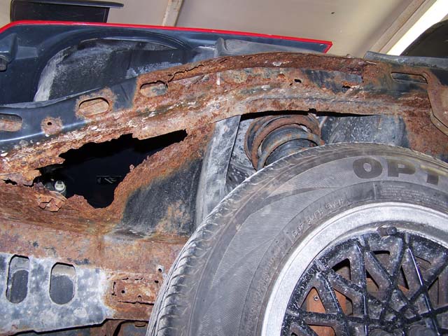

Well, reccently I pulled out my trunk carpeting and my wheel well liners only to discover that I can see through the wheel well and into the trunk. I have holes on both sides where the "tubs" meet the trunk "shelves" on either side. My options for repair are somewhat limited. As far as I know (and PLEASE correct me if Im wrong) nobody makes trunk patch panels, which leaves me to wonder, can I just cut all of that out and do away with the trunk all together and still have enough structural strength for the rear fascia? I know the lambo kit car guys do this for thier longitudnal swaps, but it isnt clear to me if thier kits have some sort of structural reinforcement the stock fiero body won't have. Any ideas or advice would be greatly appreciated. Im really loathe to have to fabricate my own sheet metal replacements with the tools I have at hand.

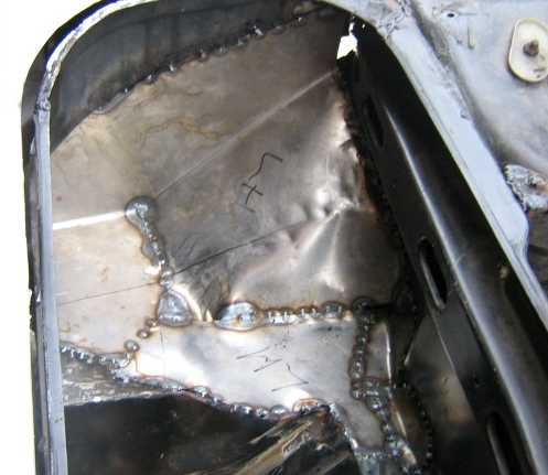

This is how I go about repairing bad steel panels.
Before
and during the repair will get after photo when finished
Signature compliments of F-I-E-R-O

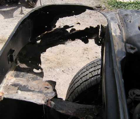

NYRED85GT
Posts: 360
From: Niagara Falls, NY
Registered: Apr 2007
Report this Post11-06-2007 10:50 PM Click Here to See the Profile for NYRED85GTSend a Private Message to NYRED85GTDirect Link to This Post
OH dear F-n goodness.....Looks like my trunk area- but not quite as bad. So what did the rest of the upper frame rails look like? My trunk sides are cut out. I plan on cutting some aluminum to fit, pop riveting the pieces together and to the car, and using silicone to seal the individual pieces so water doesn't leak.

FIEROFLYER
Posts: 3974
Registered: Oct 2002
Total ratings: 180
Report this Post11-07-2007 07:21 AM Click Here to See the Profile for FIEROFLYERSend a Private Message to FIEROFLYERDirect Link to This Post
On this car the upper frame rails were almost non existant so I used some 2"X2" square stock and welded in new ones before putting the body back on. Just have a bit more work to do then this fiero is ready fo its engine transplant. Dan
