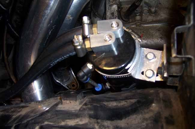

The PCV valve is gone and replaced with an oil catch can sort of like this one:
The vent tube goes in and then through the can, and into the air intake pipe. I don't think there's much vacuum on it like if it was off the manifold, but if there is any pressure, it should be vented just fine.

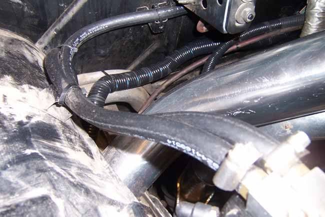

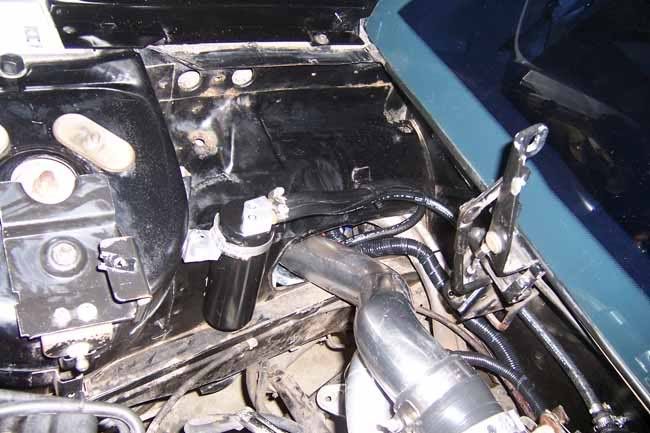

One hose goes to the valve cover and the other side goes directly to the intake pipe after the filter. No PCV valve.

I'm going to try and re-route the oil catch can to a vacuum line on the intake manifold instead of the air intake pipe.

Ok, I capped off the hose on the intake pipe, and re-routed the crank case vent to an intake manifold vacuum source.
