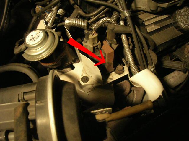

I have a 2.8 that has not been running correctly. It seems to do fine until it warms up then it loses power and starts missing. I just checked it in the dark and noticed that the manifolds are red and there are sparks jumping from the metal sleeves around the spark plugs to the exhaust manifold. The timing may be off and causing the red manifolds but I dont have access to a timing light. I believe the wires are fairly new, put on just before I bought the car. I am getting the stuff together to do an engine swap so I really dont want to put too much money into it but would like to drive it in the meantime.
Any help would be greatly appreciated.

I have looked several times for vacume leaks and found none. I pulled the sheilds off like you said and it doesnt arc anymore but the exhaust is still red. I adjusted the timing a bit and still nothing. I think that I have a bad exhaust valve leaking fuel causing it.

Ok....I took another look at it and found that the IAC was not really tite and also clicking alot when the switch was turned on so I took it off to check it out and the plunger (jet) came out. I saw threads on the shaft and it did seem to screw into a hole down in the IAC so I screwed it in and put it back on. The car wouldnt idle at all then so I took it back out and unsrewed it so it would freeley move in and out and replaced it. It nows idles but it is rough and is running worse. I then checked the exhaust again and they are still red and found more sparks on the coil pack in the small gap here...
any more ideas? I would really like to be able to drive this thing around localy.

I have the same issue with the heat shields sparking to the exhaust manifolds ....... still haven't figured that one out , tried 2 sets of new wires already :/ the Exhaust I have no experience with that problem , I assume when you say red your meaning Red Hot ?

Well I took off the heatshields and no more spark from there and I also put a new coil pack on today. I do know how to get the timming close but did find a light to borrow and set it at 10 deg BTDC. I let it warm up and took it out for a drive. Checked the exhaust when I got back and if it is still glowing , its nowhere near what it was but the car still starts missing bad after it warms up. I still cant find any vacume leaks.
Edit: I did pull off the IAC again and found that it had screwed itself in a bit ,I am assuming to adjust itself.
I also noticed that the Tach is not showing the correct RPM. I dont know how far off it is but just from driving it I can tell its not right. Its reading too high like redlining at 55-60 mph
Well, its getting closer
