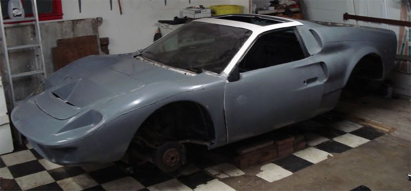

I've been ignoring this project for too long, so I've decided to start a build thread to motivate me. The Fiero carcass is an 88 Formula. My current plans are to get the body trimmed up and mounted, then start working on the drivetrain. I have a supercharged LSJ ecotec motor and trans from a Saturn ION Redline that will be going in eventually, unless I decide to sell it before I finish the body... I'm not entirely sure that the 4 cylinder will be a particularly good match for the GT40 rebody. If I do use the motor, I'm also planning to adapt the ION interior to fit the Fiero.

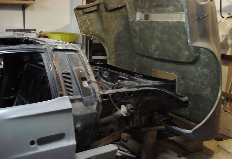

Here I have the front and rear clips resting resting on the car:
And here the door skin is sort of dangling on the outside of the door frame. It is not exactly where it is supposed to be, but close enough to take a picture:

Are you useing the fiero frame? Do you have to strech it?
Keep us posted on progress.

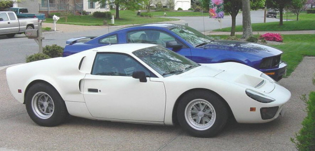

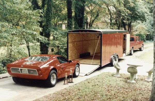

Here's another shot of mine (before I lowered it) from September, 1995 upon returning home from an FOA gathering in Kissimme, FL. I came home with 2nd place rebody AND "Pontiac Enthusiast" magazine editor's choice trophies.
I sure wish I still had that big box trailer ... only have an 18ft flatbed now.
And another (now in white primer) sitting next to my wife's Stang ...

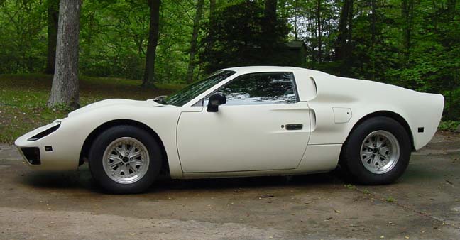

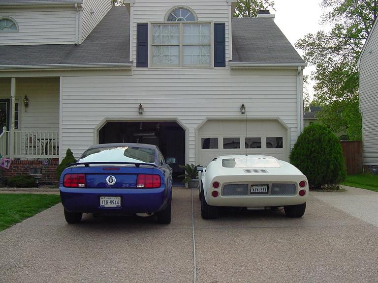

Scroll up. Do you see that white-primered car above? Same car ... but here's another one taken while I was still working on the body ...
And another sitting next to my wife's ride ...

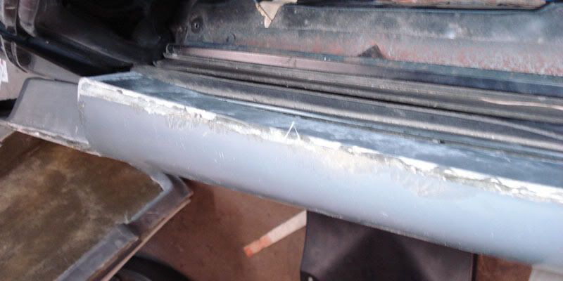

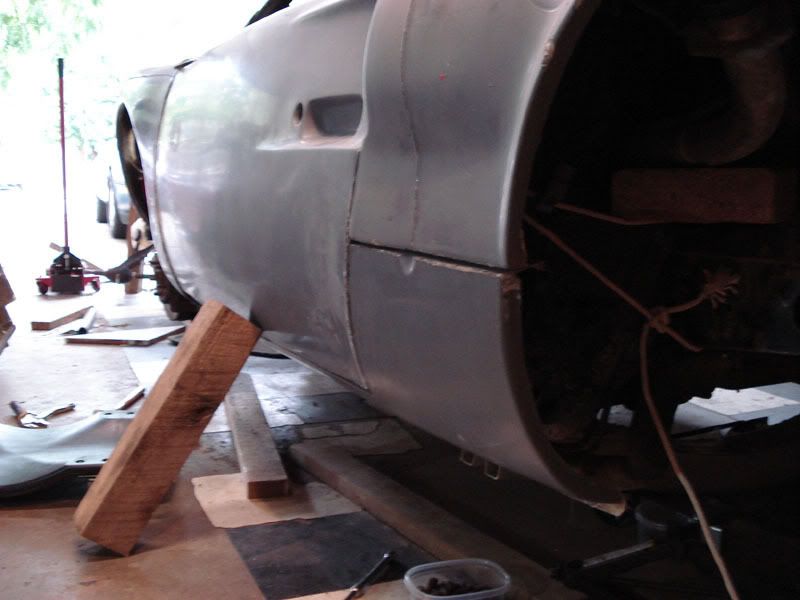

...and I'm back.

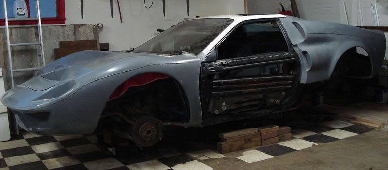

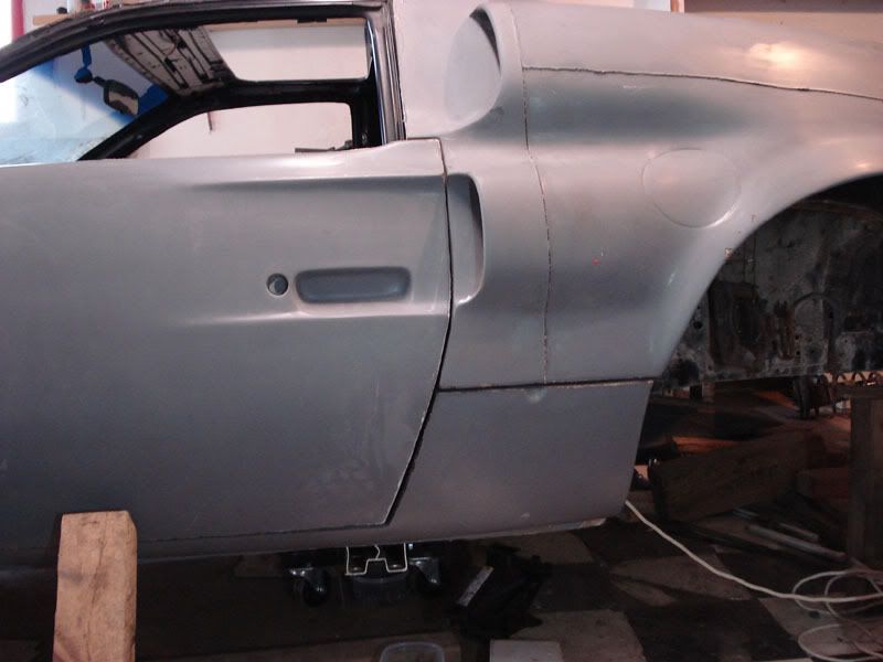

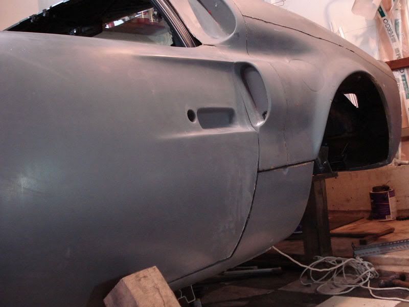

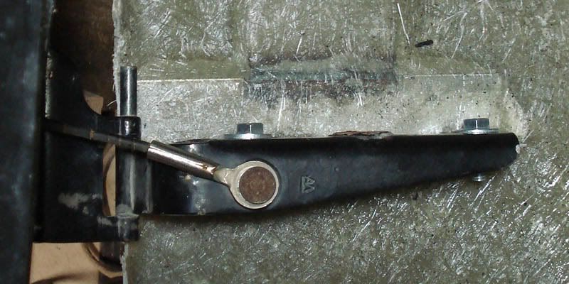

I've probably spent a good 40 hours just taking parts on and off, moving the rear clip around, and trimming the hell out of the door to get everything where I want it. I finally have the gaps on the driver side looking pretty good. The doors on this kit are made from two separate pieces that are patched together with fiberglass. On the car at Archie's, the doors have a huge gap between the door panel and the frame along the window sill. I had to trim a lot off the door panel to get the fiberglass to rest in the groove on the door frame, but eventually I got it in there. The top portion curves towards the glass at the front and rear, so I trimmed the lower inside section off in those areas so it just sort of floats next to the weatherstrip. I also had to do a lot of trimming along the side edges to get it to sit next to the door frame properly. The door fits up better with the bottom edge of the panel sitting on top of the bottom edge of the door frame, so I trimmed that up as well to allow it to slide into the door. I may still trim a little more and make a few more adjustments, but for the most part I am happy with the way this area is lined up. I’ve got the rear clip mounted and hinged, but I’m trying not to permanently fasten anything until I have the entire body together with everything lined up at once.

The fit-up looks like it's coming along nicely. I spent many hours getting my panels to line up, and still had to add material to the edges of the door panels before the gaps started to look right. Does your rear clip include an inner-panel that's supposed to meet with the top edge of your trunk? Mine did, but it fit so poorly that I cut out the inner-panel, and fabricated a separate trunk lid.

Report this Post08-04-2007 11:17 PM Click Here to See the Profile for jmarek78Send a Private Message to jmarek78Direct Link to This Post
There's no inner panel on the rear clip. Good thing too, since it already weighs too much for the hinge setup when it is hanging fully open (~110 lbs). There is a 1/8" thick plate of metal in the fiberglass running across from hinge to hinge, which seems fine when the clip is closed but when it is open all the weight ends up concentrated at the very edge around the hinges. Do you have any pictures of the hinge setup on your kit?

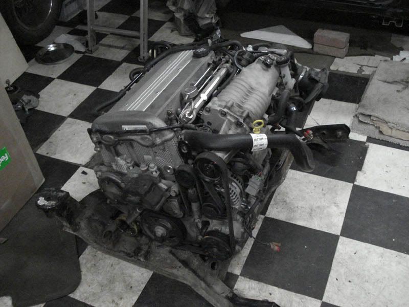

Report this Post08-05-2007 01:05 PM Click Here to See the Profile for jmarek78Send a Private Message to jmarek78Direct Link to This Post
Well I still have the LSJ, shown mocked up in the Fiero cradle. I'm torn between the lightweight advantage of this motor or the V8 rumble I could have if I swapped in an LS4 instead. Maybe I just don't have enough Fieros
Is that the supercharged ecotec by any chance? :-p What car did you get it out of, and how much did it set you back?

Yep. I pulled it from a saturn ion redline (sister car to the chevy cobalt ss). There's an F35 trans attached to it as well that you can't see in that picture. I paid $3,000 for it.
