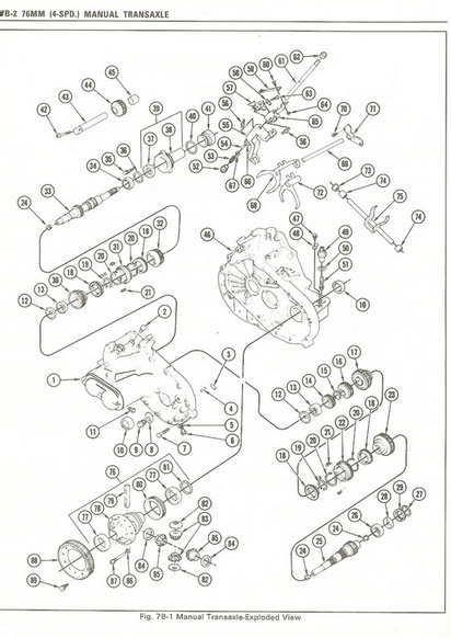

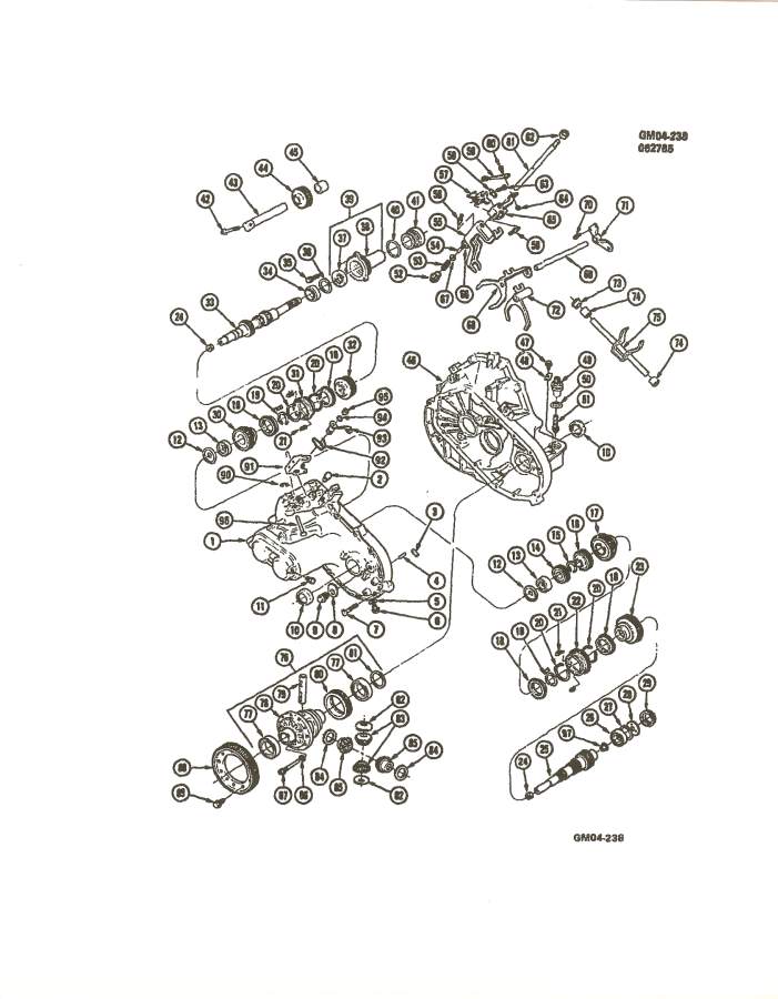

I'm not sure that tranny shops can get these parts either. I've called many trans shops and I am coming up empty on a lot of parts. These transmissions were only made for 5 years, so there just isn't much out there for support.

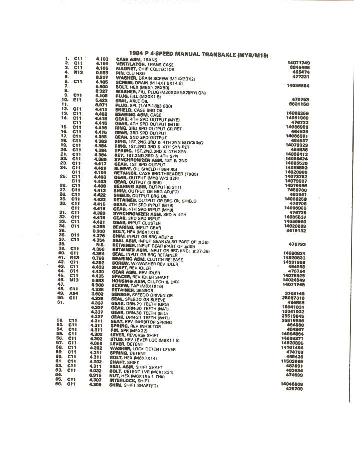

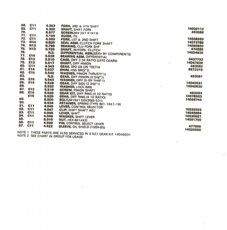

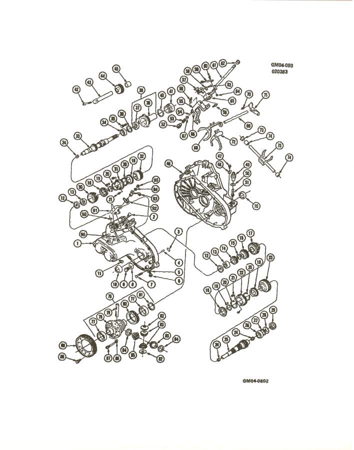

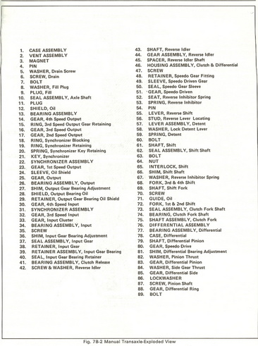

Attached below are some exploded parts list of the 4 spd muncie. The first two pictures are from the 84 factory service manual, the last three are from the 84 - 88 Fiero Parts Book.

goatnipples2002
Posts: 2055
From: Bellevue,Ne.
Registered: Jul 2005
Total ratings: 112
Report this Post08-11-2007 12:24 PM Click Here to See the Profile for goatnipples2002Click Here to visit goatnipples2002's HomePageSend a Private Message to goatnipples2002Direct Link to This Post
Thanks for the pages, but those are 84 4spds.

fieroluv
Posts: 1951
From: Ft Wayne, IN USA
Total ratings: 52
Report this Post08-11-2007 12:39 PM Click Here to See the Profile for fieroluvSend a Private Message to fieroluvDirect Link to This Post
MORE BAD NEWS.....the Chevy dealer told me that they don't carry ANY Fiero parts. So now what?
The internals are the same between the 84 and 85, the only thing that should be different is the case (reinforced in 85) and the ring and pinion gear ratio.
give me a minute and I'll scan the 85 4 spd parts book section. And you can compare them.

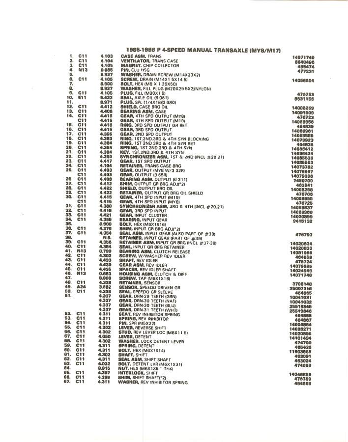

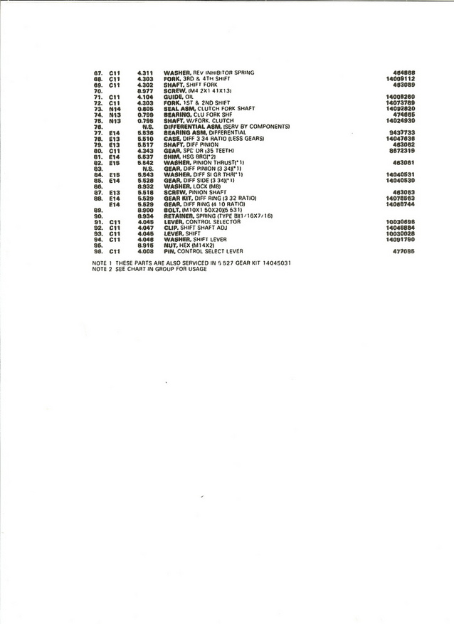

Don't tell them what it's for just give them the part number. Or you can tell them it's for a Citation they used the same transmissions as well.
The below images are for 85-86 Muncie 4spd taken from the Fiero parts book
