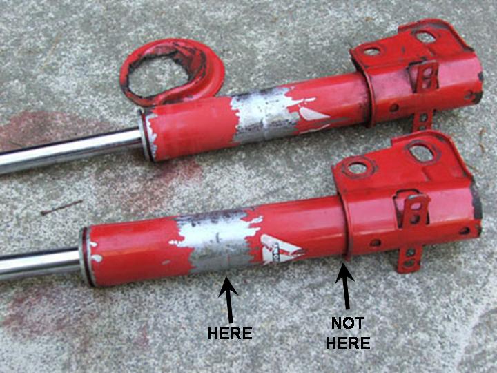

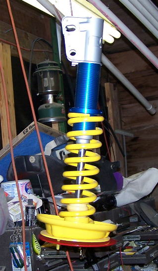

Have you tried pre-fitting those coil overs yet? I think you cut off too much material. The coils in mine stop in the spot marked "HERE" in the following photo ...
I bought my coil overs through IRM a few years back, but they're not hard to make. I believe the process requires cutting off the old coil cup or shelf from the strut, and to leave sufficient material around the strut tube so the coil over threaded tube can bear against it. Please correct me if I'm wrong, and for your sake, I hope I am wrong.
My coil overs go all the way to the base like his do.

I haven't tried them yet, but I think with the long sleeve that I have, I should be able to adjust them ok. I have seen them done both ways so it probably just depends on the sleeve and spring lengths. Right? Anyone else?

Mine are set up the same way as yours and mine work just fine.

I did mine like Jimmy but with out the upper yellow spring seat.
