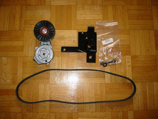

This first photo shows the parts that went into the project: a 5-rib 45" long belt, a belt tensioner from a FWD 60° V6 (including its mounting bolt), and Dodgerunner's bracket.
I have this belt tensionner, from my fwd 3400 V6 (Grand Am). But the pulley is ribbed. Where did you take this flat pulley? or did you machined it ?
Edit: Ok...Ive got to the DodgeRunner website and saw the list. The 2003 3400 Grand Am is not included in this...the ribbed pulley that probably the reason. I will have to go to the scrapyard again to pull a unribbed flat pulley.

Look for a FWD car with a 2.8 or 3.1 (late 80s to late 90s, I think). Those will have the smooth pulley.
