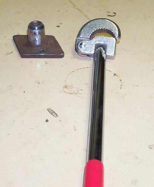

Remove tailights and then rear facia. Now you can see the exposed frame rails with the nuts. Support cradle weight, use a plumbers self adjusting wrench to hold the nuts and oosen them with a 1/2" impact wrench from below. If the bolts don't budge then apply heat and some PB blaster when cool. Then try again. If all goes well the Job takes about 30 minutes to complete. Those nuts are the easy one. The front bolts when rusted fast are much harder to get loose

As Dennis pointed out, there is a way to get ahold of the broken loose witch hat nut, without damaging the chassis. Removal of the rear clip & rear bumper gives you access into the chassis rail from the rearend. Using a common faucet wrench, you can get the right "angle on the dangle" and grip the nut. Best to have one person focus on holding the nut, and another to work on turning the bolt. It may not be too tight, once you have a grip.
Repairing the thing can be done without causing damage, also. This involves welding the witch hat nut onto a small steel strap or plate, and re-inserting it into the chassis rail.
