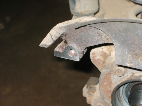

Then you have to do a little grinding to the area of the caliper mount so it will clear the GA rotor, this does not affect how the GA calpiper will mount.

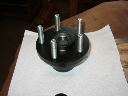

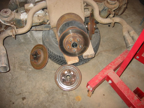

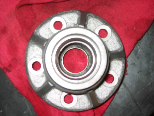

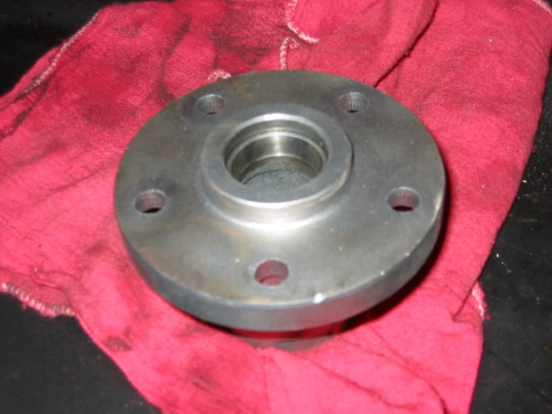

OK, here's a pic of several front rotor/hubs before machining.
These two pics are after the rotor area is machine off, note there are no studs in the hub yet, more on that later.
Here's a pic of a completed rotor with new studs.
The reason for the new studs is because when the wheel sits on the old rotor/hub there is nothing between it and the rotor/hub.
When you do this upgrade you now have a GA rotor between the hub and the wheel so you need a slightly longer stud than stock.
I don't have the exact length but measure a stock one and add the thickness of the GA rotor.
The machined hubs can be installed back on the spindle and if you were careful you can use the old bearings a races.

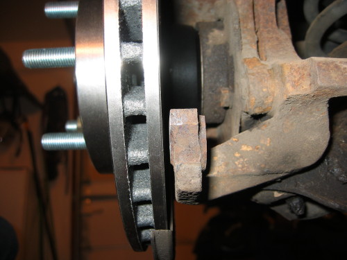

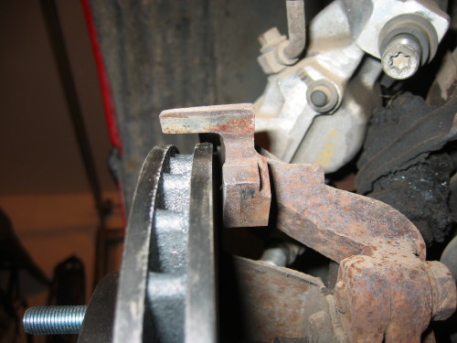

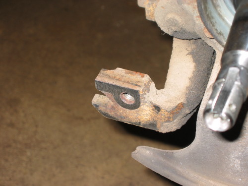

These are the areas you need to grind down so the GA rotor has clearance.
These pics show the clearance after grinding.
You still have to tweak the brake hose a little to aleviate stress due to the GA caliper being slightly different but that's pretty easy.
Hardest part is finding someone to machine down the rotor/hub for you.

Keep in mind, this effectivly spaces the front wheels out the thickness of the rotor (~3/8") which is why I have not done the front.

Measure the inside diameter of the "hats" on the GA rotors, and machine the Fiero hubs accordingly. I think the most popular method is to turn 'em down on a lathe.
