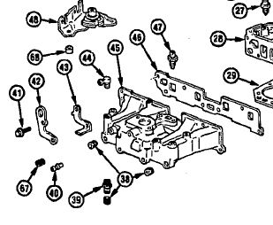

Not to hijack, but where does the other end of that hose go? I have an 88 and there is no such hose and I've had the car since nearly new. There is what looks like a factory plug in the bottom of the manifold, the same as the two on the front. The parts manual also shows three plugs in the 87/88 manifold.
edit: Here's the parts breakout---
The three plugs are #38 but #39 is the "control, htr wtr hose", p/n 10042695 similar description to the part used in previous years but different number. Maybe some came with the hose and others with the plug?
It's the heater core supply line. #39 in the pic. It's underneath the intake manifold. It is a quick connect for a hose goes to a hard line that follows the right side lower framerail leading to another a quick connect on the lower firewall, after which it bends around under the car to follow the heater return line to the heater core. Both of my 88 2.5Ls had this line. Where is the heater core supply line on yours if it isn't there? Does your heater work? Maybe someone disconnected it and plugged it.
