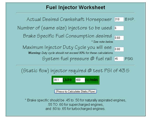

* Brake specific should be .45 to .50 for naturally aspirated engines,
.55 TO .60 for supercharged engines,
and .60 to .65 for turbocharged engines.
Your BSFC is too low according to the chart for a turbo.

yea, I guess you're right, according to this formula, my injectors will only be good for 310bhp.
We'll see what happens.

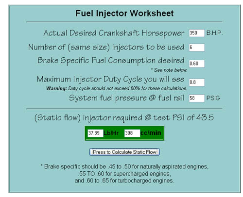

although, can't you just raise the fuel pressure and drop the required size of your injectors??
If I use the same formula as above, but with a higher fuel pressure, my 38 lb/hr injectors would work fine for my desired HP.
If you upgrade the fuel system enough, it'd be easy to run 55psi

I agree, just use an adjustable fuel pressure regulator. You could also use a boost referenced fuel pressure regulator as long as you tune ignition retard into your ECM.
