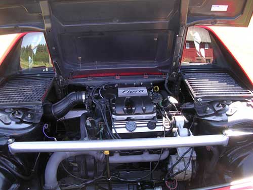

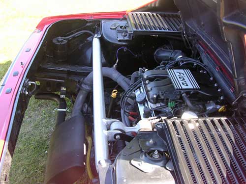

You're buddy at the CTHC at Archie's mentioned the same thing to me. Here's what he did (from the CHTC thread)
Attention to detail:
I had a chance to chit-chat with Chuck at the CTCH. What caught my eyes was the detail above the strut towers. I asked about it and he had the area welded over and over again until the material reached a certan height which strenghtens the area and reduces flex plus it looks good if you're painting it. He mention that the rubbery material was a pain to remove.
motortv's turbo LT1:

got a better pic of what everyone is talking about, Tina's pic has been replaced with a different one it seems
ltlfrari
Posts: 5356
From: Wake Forest,NC,USA
Total ratings: 127
Report this Post11-01-2006 10:32 PM Click Here to See the Profile for ltlfrariClick Here to visit ltlfrari's HomePageSend a Private Message to ltlfrariDirect Link to This Post
Methinks your engine is sorta pointed the wrong way
I noticed the original pic had changed too.
Dave E
www.ltlfrari.com
FieroWannaBe
Posts: 2294
Registered: Oct 2004
Report this Post11-01-2006 11:38 PM Click Here to See the Profile for FieroWannaBeSend a Private Message to FieroWannaBeDirect Link to This Post
looks right to me, pulleys towards the cabin, putting the transmission behind the motor, you know mid-engine

What the ... anybody missing a passenger seat ?
I think we got a straggler here.
[This message has been edited by Tina (edited 11-02-2006).]
Posts: 32982
Total ratings: 403
Report this Post11-02-2006 08:12 PM Click Here to See the Profile for Jake_DragonSend a Private Message to Jake_DragonDirect Link to This Post
Why did you post a picture of your dyno?
Jefrysuko
Posts: 3491
From: Oreana IL
Registered: Apr 2000
Feedback score:    (17)
Total ratings: 108
Report this Post11-02-2006 09:19 PM Click Here to See the Profile for JefrysukoSend a Private Message to JefrysukoDirect Link to This Post
That's where her hubby is allowed to park his dyno.
Now this is Tina's Dyno!
Tina
Posts: 2858
From: At an elevation of 8564 feet.
Total ratings: 119
Report this Post11-03-2006 06:59 PM Click Here to See the Profile for TinaSend a Private Message to TinaDirect Link to This Post
Dyno? I thought it was a pic of a Fiero seat that had replaced the pic of a strut tower.
Anybody wanna fill me in on what the (beep) is going on ?
Tina
Jefrysuko, that pic of yours doesn't exactly look like a dyno either.
