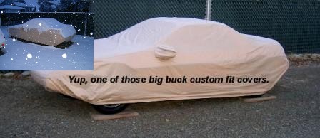

I used to store my fiero for the winter (well.. still do). I would just put the tires on plywood, spread some moth balls around (inside and out), unhook the battery, cover it and forget it.
You can put a trickle charger on it, but I can't say I have ever had a problem with letting the battery sit all winter (unhooked).

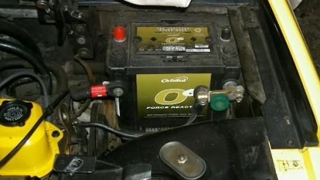

Yes, disconnect the battery. if it's fully charged it should be fine for a few months. Don;t believe that float charge crap, the 300+$ computerized float chargers for boats still boil out the batteries, especially when they are a few years old.
the added benefit of disconnecting the battery is safety, no power so no potential short/fire issues. A few hours on a charger
after 3 months should be all you need to start the car, tho if the battery is good, and not connected, it shouldn;t even need that.

I put a knife switch on my '88 that seems to work well. I got it a Advance Auto Parts. When I park it I just open the knife switch. No battery drain between starts.
