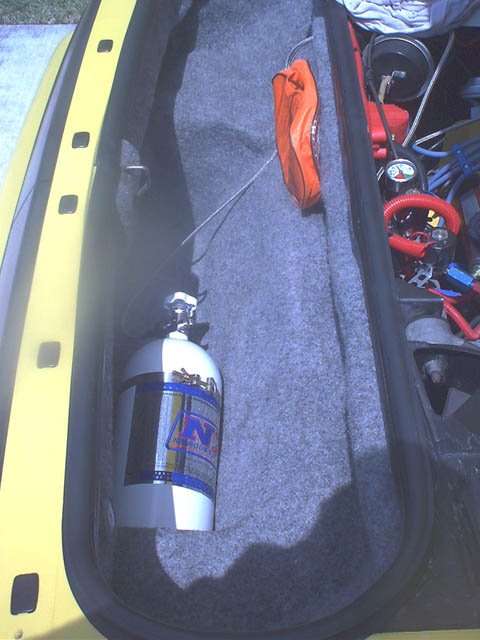

Welcome to the forum. This is by far the fastest, cheapest way for big power increase. You will kick butt immediately.
