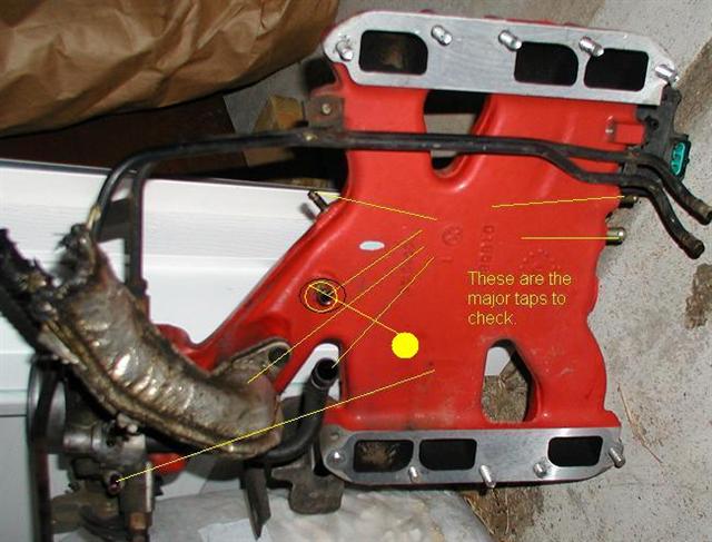

On a 2.8L theres a nipple on the lower intake mainfold, by the distributor, right underneath the egr tube on the upper intake manifold. What conects to this. there is alot of air being sucked into there but i dont know where the hell it goes. I have a picture if anybody needs to see it, just give me your email and i will send it.

If it's the big one pointing up out of the manifold it's the tube that supplies the idle air and air for the cold start injector for starting.
Should have a short rubber tube about three" long that connects to the bottom of the Upper intake.

It is a vacuum line,which goes, I THINK(!!!) to the PCV, or the canister..but I am only guessing..somebody will tell you for sure.

if it's the one I'm thinking there's a corrresponding nipple hanging down from the plenum, and there's a length of hose that goes between the 2....

does anyone have a vacuum diagram, and not the one thats under the hood?

https://www.fiero.nl/forum/Forum2/HTML/073836.html
The above does not show the one I think you are looking for.

Where does that black rubber hose go that is by the egr tube. (second yellow line from the bottom on the left) That hose connects to the nipple im talking about. where does it go from the nipple

Nice picture Dodgerunner!! Took the liberty of marking in yellow the one I think he means..this is the one which goes to the PCV..I think

fierofetish
19173 posts
Member since Jul 2003
Hmmm...got it wrong, it seems!! That hose goes into the lower plenum, behind the distributor. It is the hose that connects the IAC valve to the lower plenum, near the coldstart injector.

the hose that goes to the IAC. theres a huge hole on the back of my Throttle body, on the bottom, in the middle. i can stick my pinky finger onto the hole.
Aslo. i have this "L" shaped metal tube. dont know hwere this goes. (sorry, its been year since this thing was put together right)

If you mean this tap, it's the one that goes to the black pipe that goes to the
TB. It's for the idle air and cold start.
Or do you mean the hold in the back of the tube from the air cleaner to the TB that has a large hole in the back of it. That hole goes to the pipe that goes to the back valve cover. It is the clean air supply for the EGR system.

yes, thats one! does the pipe just slide right in there?

There is a short rubber hose that couples them together.
