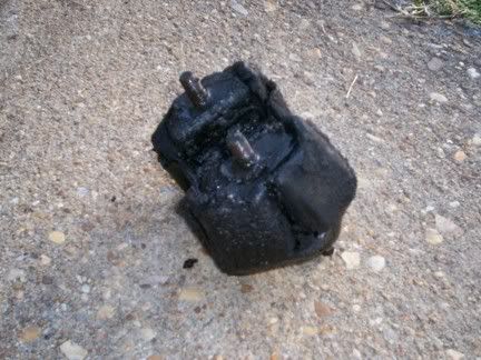

Had to replace my alternator, the bad bearings have chewed up another belt and they squeal all the time. Changed the oil, and while I was at it, I changed the front (right) motor mount. Here's the old one, swollen from oil exposure. So much crud under there, I sprayed the undercarriage with some citrus based solvent and trundled down to the local car wash to hose it all down. I notice a little change in city driving already, I'll be driving it on the highway tomorrow... I checked the rear tie rod connections and one has the boot bolted to the frame collapsed. Next Project, get those Rodney Dickman parts on....
