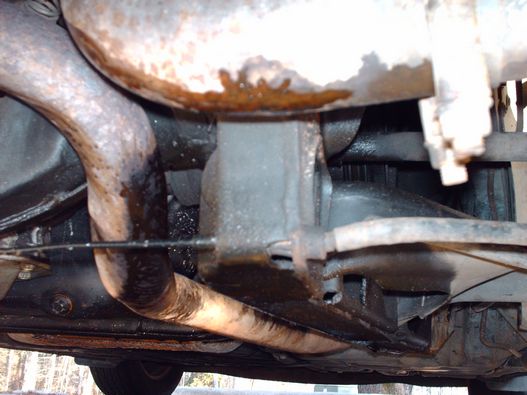

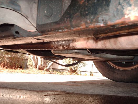

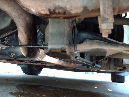

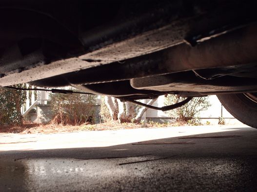

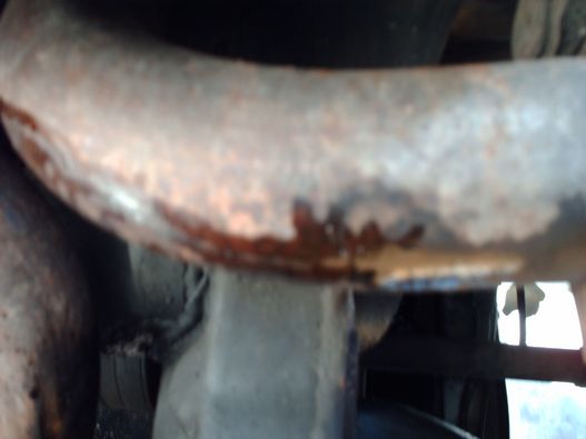

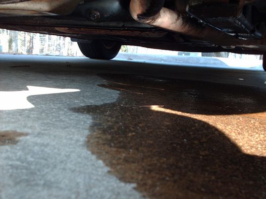

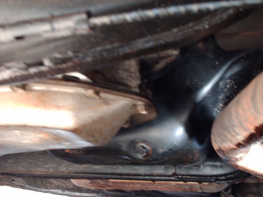

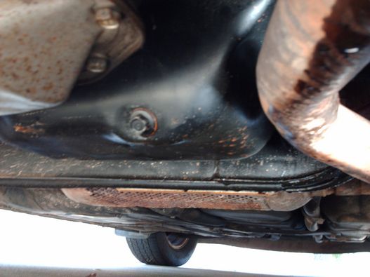

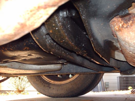

Okay guys. After it finally dried out from all the rain and I got some time, we snapped pics of the oil leak and the underside of the car. The leak is definitely coming from the rear passenger side. Here are some pics to help with the diagnosis:
Here're pics of the underside of the car in that spot:

It looks like the leak may be coming from a gasket of some sort. The bolts are dry and it seems like the oil is travelling along the pipe and then leaking down onto the ground.
Any ideas on what it might be? How to fix it? Is it something that I can do myself?

Looks like it may be comming from the front main bearing seal. Look at the front motor mount and see if it is covered with oil.

I'd check the oil pressure sender before digging into the front bearing. The sender is visible from the top of the engine on the side the battery is on. It is sort of between the battery and the intake manifold. It is prone to leaking. It might be a good idea to check the tube that connects to the sender as well.
