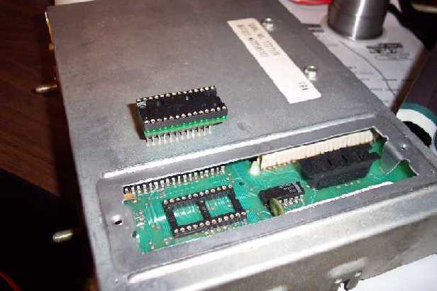

Pretty much the same procedure. I'd recommend changing the stock chip (EPROM) over to a flash chip, and using a ZIF socket. (put a regular 24-pin socket in the ECM, a 24-to-28 pin adapter, and then plug a ZIF socket in to that). You'll need a 24-to-28 adapter from someone like Craig Moates at http://www.moates.net
(can't find my ZIF socket right now, but that's an '86 Fiero ECM, socketed, with a 24-to-28 adapter on top)
