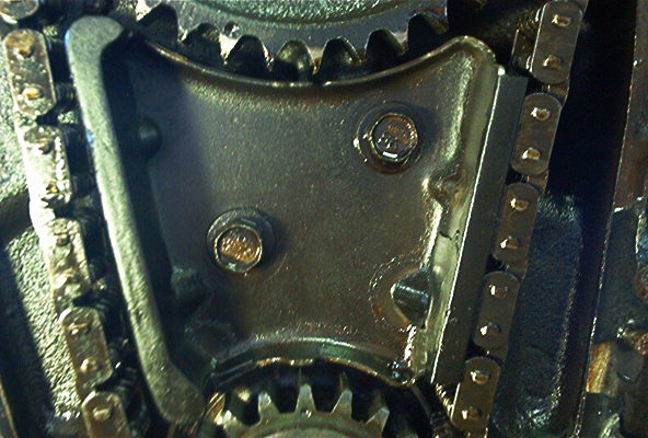

Every once and awhile the question gets raised if it's possible a 2.8 has jumped it's timing chain. There are a number of people on here that swear up and down that it is impossible, and they will argue with you to no end.
Well here's proof that it can and does happen.
With the timing chain and gears properly installed, the dots on both the cranskshaft and camshaft gears point up at 12 o'clock with number 1 cylinder at TDC - Top Dead Center. With number 4 cylinder at TDC, the dots point towards each other- crankshaft gear at 12 o'clock, and the camshaft gear at 6 o'clock.

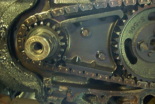

In these pictures I set number 4 cylinder at TDC to get better view of the dots in refrence to one another. The timing chain has jumped 2 teeth.

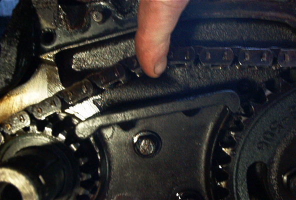

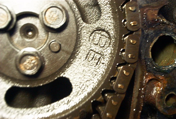

The chain doesn't look quite 2 teeth out due to the amount of wear on the camshaft gear and chain as seen in this next picture.
Here is the amount of stretch due to the worn chain and gears.

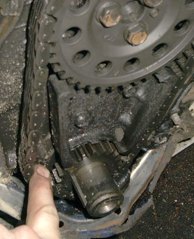

In this picture you can see the chain hanging well off the back side of the crankshaft pulley.

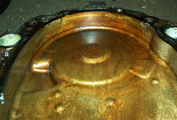

Here is the inside of the timing cover, you can see the timing chain has never made any contact with the timing cover.

This car came into the shop with no power and no ability to rev over 3500 RPM, and a rough idle. Checking ignition timing showed it set at 31°. Compression was 150 psi at the lowest cylinder with the chain that way.
