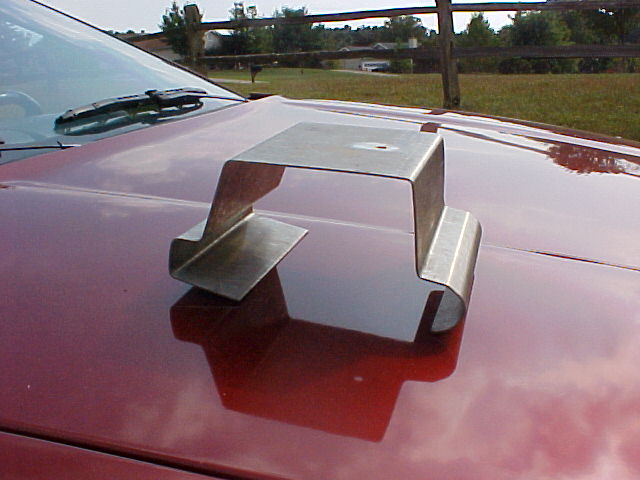

One of the guys in our club (fierofool/Charlie) made a bracket that clamps to the top of the center console/glove box.
IIRC it was made out of a thin sheet of springy steel, and clamps around the back and front (with the glove box door open) edges of the console top. It was sturdy enough to support the camera during RFTH, and allows forward and backward facing views.
Hopefully he'll see this and chime in.

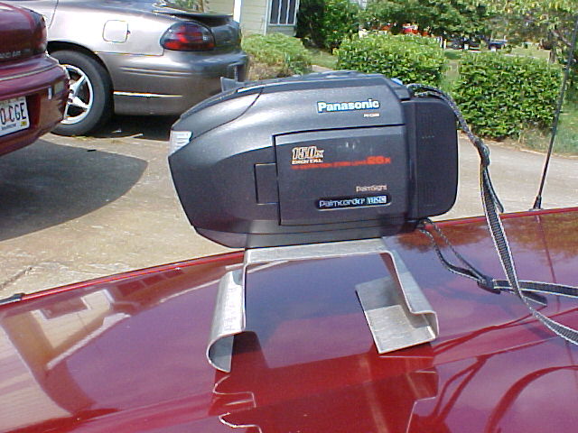

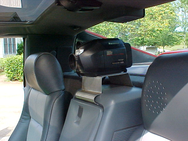

Thanks Raydar for queing me in on this. My mount is made from stainless steel. It fits around the back edge of the top of the console by removing the 2 screws behind the glove box, tipping the console forward and inserting the mount. Put the console back and install the 2 screws.
It's spring loaded and clamps tight in the glove box door recess. The glove box is fully operational with the mount installed. As Steve said, it's solid enough to withstand the rigors of Run For The Hills with a camera mounted to it. Works great with a camera with a remote control.

dont these videos get real shaky? any vibration dampening?
that "clamp" of fierofool's looks like it would amplify the shakes?

I've seen the footage from the Rally back in April its not shaky at all, considering how we were driving.

fierofool
Posts: 12985
From: Auburn, Georgia USA
Total ratings: 153
Report this Post06-24-2005 07:25 PM Click Here to See the Profile for fierofoolClick Here to visit fierofool's HomePageSend a Private Message to fierofoolDirect Link to This Post
With Electronic Image Stabilization, the video is very stable. Occasionally there were some bumps in the road and at the ends of bridges that was beyond the limits of the EIS. Side to side stabilization gives the effect of a slight panning action as you turn the curves.
Videos do look much slower than actuality. Zooming up a bit gives the impression of going faster, but you tend to lose the inside car view that many people seemed to have wanted, and any vibration is magnified by the power of magnification.

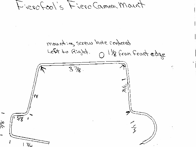

My mount is made from stainless steel. I had planned to build and sell them, but my supply of free stainless strips has dried up. If I had to purchase the metal, I couldn't sell them at the planned price of $25. I wouldn't use steel due to the possibility of rust stains on the console. 40 to 60 gauge aluminum might be adequate.
I'll take some dimensions and post them. You will have to work out the angles. I am not a machinist, and I constructed this from a picture in my head, without drawings. Anyone is welcome to construct one for their own use, but not for resale.

As promised, here's a diagram with measurements. Measurements are in inches.
With this mount being at the approximate center of the car, it's very stable. Takes about 5 minutes to install or remove.

Hey Fierofool.......nice mount........very similar to some of the mounts that I've built for various cars.....starting with 1 of my old race cars......then 1 for a skydiving helmet, and some for other cars for friends and myself.......all built out of brushed stainless steel, much like what I'm using on my new interior on my 88 GT. My dimensions were a little different, but the finished product looked very similar, and woked very well.
