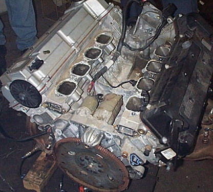

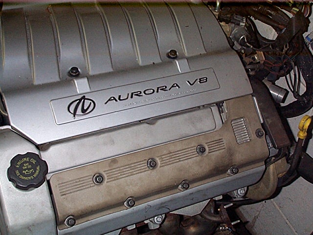

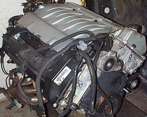

The V8 Aurora as it was seen at our last BBQ.
With the intake torn down. The starter can easily be seen.

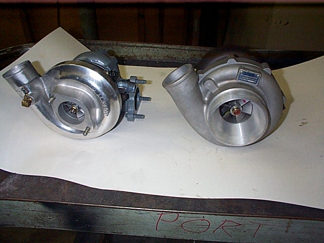

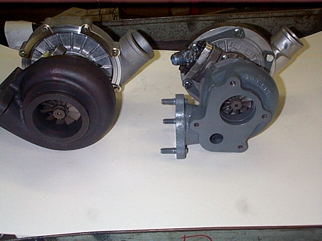

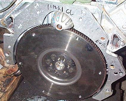

Before the pictures of the turbos, a picture of the flywheel now making its home on the Aurora as well as the adaptor plate for the 6 speed.
The Turbo sitting next to a turbo similar to the one on Chris' current turbo on the 3.4 Twin Cam.

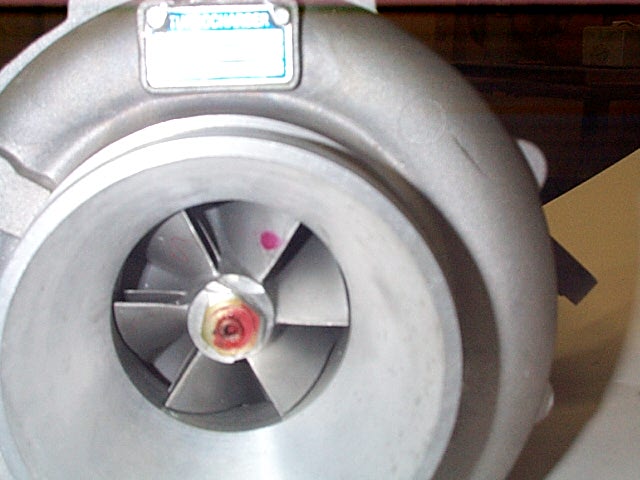

Ball bearings. The ID plate didn't come out well but it reads:
Type: T3
Part Number Super T70
Comparison of the exhaust side.

That turbo looks appropriate for go fast.
even that T3 looks like a pretty nice turbo for a 3.4 Pushrod or a 2.8. The ex housing is alittle small for anything bigger then that. Is it a T3 super 70 or a hybrid T3-T4?
It is a hybid t3/t4 .63/.60...
that lil one looks very familiar

The Aurora is a Northstar with slightly smaller pistons, same intake cams as 275 N*, smaller intake valves and a few other minor differences. It's rated at 250 hp vs 275 or 300 for the N*. Almost all parts interchange. Looks like a good project start there. Suggest you pack the injectors in something before they varnish shut. You'll probably have larger injectors anyway.
Didn't want an aluminum flywheel?
The use of the SPEC aluminum flywheel was deemed unnecessary for the drivability and performance of the Aurora Turbo.
No kidding...
I was wondering exactly why it was deemed unecessary...
Personal choice based on past experience with aluminum flywheels. He doesn't like the way aluminum flywheels affect daily driving.
