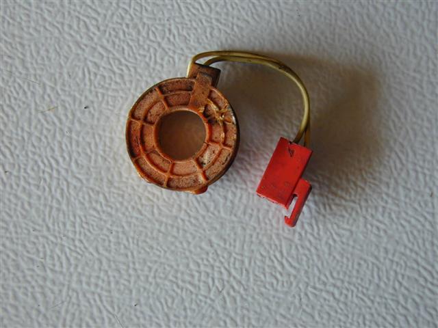

"Update on the Fix"
After a couple of days tracking down my starting problem, it
ended up being the distribitor pick-up coil. what a "headache"
finding the problem........but, it was a eazy fix.
The bad one:

Report this Post04-23-2005 05:27 PM Click Here to See the Profile for 2000RagTopSend a Private Message to 2000RagTopDirect Link to This Post
Starting problem Fixed..........."pick-up coil"
