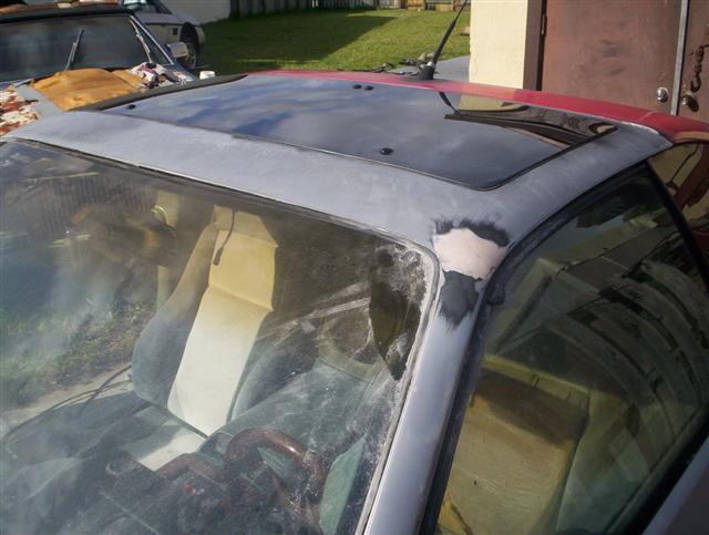

I did it the easier way by cutting and splicing and fiberglassing the roof in less time and less work.
