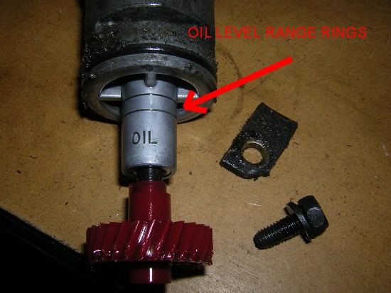

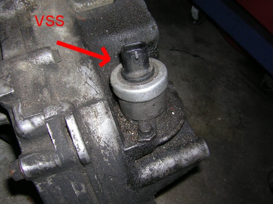

You can use either 10w-30 motor oil or auto transmission fluid, DO NOT MIX THE TWO TYPES, its either or. Find out what is in it and service with that type. Your speedometer sender (VSS) is the actual tranny fluid gauge. You'll have to remove the bolt that holds the hold-down on then wiggle the VSS until it comes out of the tranny. Be carefull not to bump the speedo gear as to it might fall off into the tranny. The speedo will have two rings on the casing and that is the range for your fluid level.

4. Pulled speed sensor, fluid appears to be full (also no external leakage found)

Correction to the fluid level, my sensor does not have the "range lines ". My fluid is only about a 8th of an inch up on the metal on the gear end of the sensor. I'll purchase the http://www.pennzoil.com/products/gear_oil/syncro_fluid.html and refill the transmission toworrow. The fluid in there is not "milky" but does not look clean either. Is there a "best practice" for draining the fluid??
