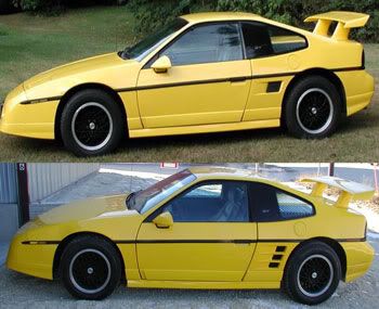

PLEASE NOTE MY NEW ADDRESS
Rodney Dickman's Fiero accessories

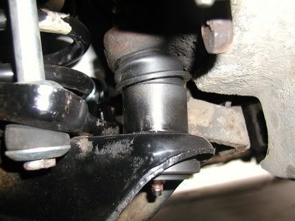

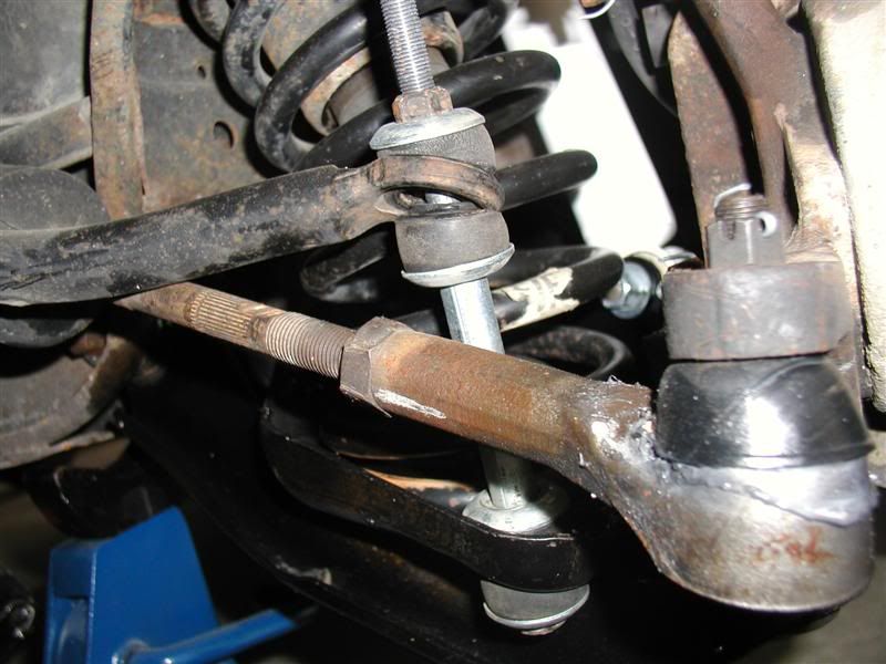

The '88s will require a 1" longer end link or the tie rod and sway bar will hit when when the steering wheel is turned 3/4 to 1 turn. On the '88, the tie rod passes under the sway bar to connect to the steering arm on the knuckle. Normally there is about an inch clearance between them.
The new ball joint moves the knuckle 1" higher (further away from the LCA) and thus closer to the sway bar which is fixed to the LCA by the end link.
The picture on the left is with Rodney's ball joint and the stock end link. The picture on the right is a temp fix with all thread rod and an additional 1" spacer.
I helped install these on Sparkles' car and they work great. The end link is the only problem and that is an easy fix, especially so if Rodney offers some parts for this.
So do you know if this will be a problem on the 87' then? I pm'd Sparkles to see how he liked them or if he has had a problem, but haven't gotten a reply. Just really want to know if the ride is changed or if it's rougher say compared to lowering springs.

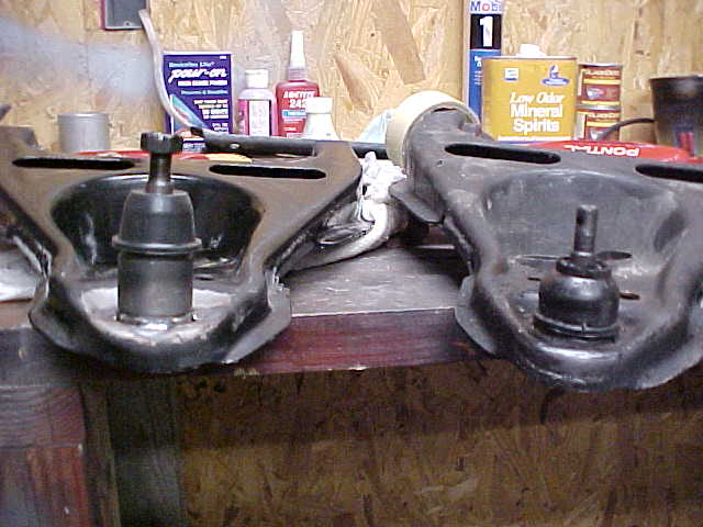

I'm having trouble picturing how a ball joint can lower the car. I know a little about the 88 suspension having replaced springs, shocks and end-links, but I just can't visualize how the ball joint can lower the car. Any help here? Is the ball joint just physically 1 inch shorter? It's hard for me to visualize a ball joint being 1 inch shorter.
And how hard are these to install? And if you put on a 1" drop spring would it drop the car 2"? I think it would and it would also fix the endlink problem, as I have 1" drop springs and the end-links are nearly too long.

There are several threads in the archives discussing how this works with lots of nice pictures but, to put it simply:
The top of the spring attaches to the chassis, the bottom attaches to the lower A-arm. If you move the lower A-arm down, the chassis will follow (remember, the spring length will no change). Since the height of the spindle is determined by the wheel/tire selection, it cannot change. Ergo, the body will drop if you drop the lower A-arm.

1" longer actually - they raise the knuckle up an inch from the lower control arm.. which lowers the car an inch
Exactly !!
I am currently working on this install and will have everything cleaned up, painted and back on by this weekend I hope.
I was going to wait and post all the pics when I have finished but just so some will have a better idea of what it looks like and can better picture it in there mind. Side by side , 1 new drop ball joint ( one on the left) and stock ball joint (one on the right)

Originally posted by Zoom88:
Exactly !!
Thanks for the picture Zoom88 and verbal description, MrFixit58.

The mechanic said he didn't notice any clearance problems with the Sway bar end links, bump stop, or rim clearance. I did notice a clunk when I cranked the wheel to get out of the parking lot, but as I hate temps colder than 30 degrees, I chose to park the car in the storage facility till the temps come up and I can get down and crawl around to see how it looks!! At that time if i can get some pictures I will. I plan on working on the rear before or at the latest in March so then I will pull the front wheels off and take some good pictures of these on a stock suspension.
One more thing is they did not weld them in as they said they went in way tighter than OEM balljoints so they did not see a reason to tack weld them. I guess we'll see!!!
Another big Kudos to you Rodney...Thanks!!
Dan
I'll see if the pics I took can show a difference. Not quite the right angle, but it's all I have right now, the lower picture is after installation. Remember that the rear is not lowered yet.

Hey DanFiero,
I hope you re-read this link. That 'clunk' you heard leaving the mechanics probably was your sway bar getting hit by the endlink because you didn't lenghthen the links by an inch also. Your mechanic didn't notice clearance issues because he obviously didn't turn the wheel when checking. Don't get me wrong, as I didn't think of it either. See L67Formula's pics in the middle of this page. https://www.fiero.nl/forum/Forum2/HTML/057689.html
Good luck and nice car,
John

Come on now... what used to be a ball joint pressed into a control arm is now a ball joint sitting on top of a tall tower. It's been changed drasticly.
The only thing I'm saying is, after working on cars for 20 years, and seeing many suspension related failures on factory designs, when I look at those it gives me a feeling of concern.
Auto makers spend millions on research and development, and they still have failures. As far as I know, the research and development on these lowering ball joints are just a few forum members. Has anyone installed these ball joints and taken their car to a test facility for hard evasive manuvers at highway speeds?

Well, I finally got the car up on stands and had a chance to take some pictures. The car is a stock 87' GT. The sway bar links do need to be replaced as they do hit at full lock turn (see picture).
Here's a picture of the balljoint installed:
If someone knows the part number or the make and model that the longer end links come from, please let me know!!
thanks,
Dan

https://www.fiero.nl/forum/Forum2/HTML/060015.html
Check this thread for recent info... sounds like a solution is being formulated as we speak.
Thanks for the pics! I'm feeling good about this mod. Always wanted to tweak the fender gap without having to lower the whole car...
