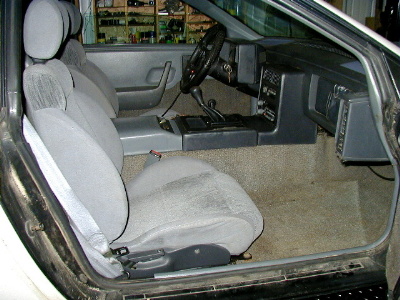

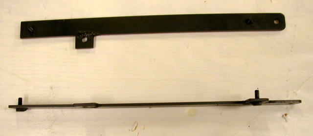

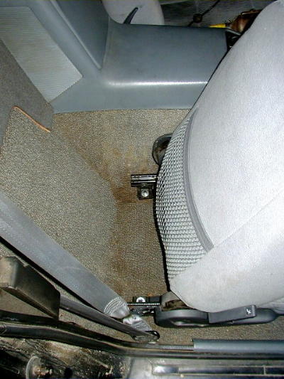

Here are some pics of rails I made to install 94 Satrun seats in
my 86 Notchy.

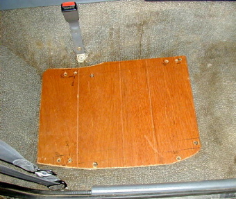

I first made a template with a piece of paneling to get stud locations.
With the template in place I set the seat in position and marked the
bolt holes. I used the template to determine the rail size and hole locations.
The rails are made from 3/16" x 1 1/4" cold rolled steel. I welded in 5/16" x
1" bolts as studs for the Saty seats.
