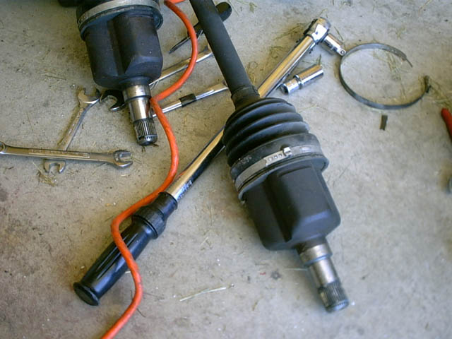

Ok,
we have the 4.9/4t60e in but have not been able to find the correct passenger side axle. I see where many people have had the same problem.
We need an answer from someone who has this setup--not a lot of hearsay and rhetoric please. We have already tried the passenger side pont 6000-light duty brakes-no abs----this axle appears to be about an inch too long.
Does anyone know for sure which one fits and works??
Thank you Jeff

do you have to dissasemble this axle? because we bought a fiero lhs manual tranny axle and it had a female end on it---it should be male---so we returned that one and got a pont 6000 passenger side---it's too long.
Thanks for your help
Sounds like they gave you an automatic axle?

We just finished doing the 3100/4T60E, and if you are sure of these facts:
a) You have the transmission in the same left to right orientation as factory (referencing the bellhousing face)
b) You have the 4T60E (not the 4T440 or 4T65E)
c) You are using an 84-87 cradle
then you can use what we did:
Passenger's (RIGHT-HAND!) side 1994 Grand Prix 4T60E axle and inner joint with a 1994 Beretta 4T60E outer joint with the ABS ring knocked off. The GP axle itself will work with the Beretta boot and has the same spline as the Beretta's joint. This setup is the perfect length (what GM would have done) and works great (as attested to by the two 215mm wide patches of sod which were swiftly removed from Andy's sister's yard by the recently completed conversion.)

lhs pont 6000 axle and a lhs manual fiero axle----both lhs axles--then of course one of them will have the wrong end on it.
SO what is the easiest fix for this problem??

Originally posted by jeffndebrus:
lhs(drivers side) axle on a manual fiero tranny has a male or female tripot end on it??
MALE on both sides. That's why I thought you had an auto axle by mistake.

Update and Resolution!!!! AutoBozone Had not 1 but 2 Mis-boxed Axles. Stopped at two competitors And WOW!! they were corect, Went to AZ and guess what, DOH!! Call otehr store and they have the right one!!! Man I cant really blame the counter guys as they just read the boxes. They are sending back both those as mis-packaged. OK WE KNOW FOR A FACT NOW!!!
4.9l Swap using 4t60E
Driver side
89 Pontiac 6000 4spd auto, no abs, light duty, 2wd Left Side
Pass Side
84-87 Fiero Manual Trans left side.
