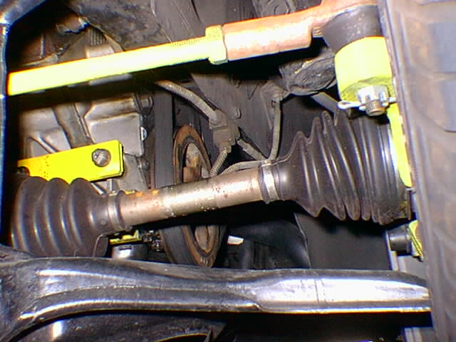

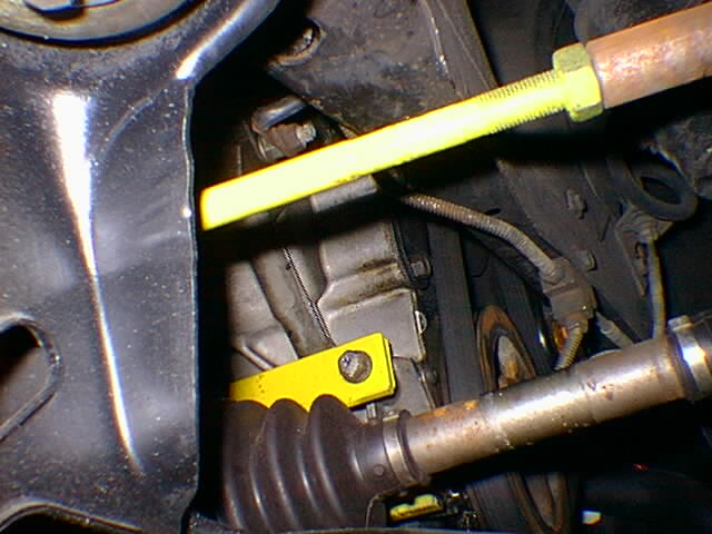

OK.....what is the solution for this setup....I have followed other advice and my passenger side shaft is WAY short....I understand the 88 is different than the 84-87 (?) I hear that the 88 requires a specially made passenger shaft.
HELP!?

OK...went and exchanged the 8437 for the 8430 and it is too long...the suspension bottoms when the shaft is horizontal....looks like it needs to be 1" shorter...so...
The 8471 fits ok on the drivers side - this is the 90 Pontiac 6000/4T60/Light Duty Brakes left axle
The 8437 is too short by about 2.5" - this is the left axle from a manual Fiero
The 8430 is too long by about an inch (guess) - this is the 87 Pontiac 6000/4T60/Light Right side
What the hell is going on here? Can I just get one shaft shortened?
