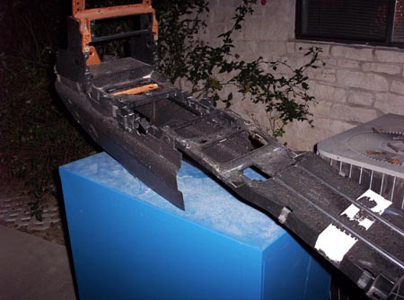

I took the plastic skeleton out and the thing busted in every screwhole. Has anybody repaired there's or found a new one. If anybody has one in decent condition i would be interested in buying it.

This is the method that I used... quite sucessfully
https://www.fiero.nl/forum/Archives/Archive-000001/HTML/20040223-2-043281.html
Good luck

thanks topcat, would you happen to remember what brand that plastic epoxy was? Anybody else?

It has been a while, but I think the name was Plastic Welding System... or close to that. I got it from WalMart, and it is a two part mixture. It came in two syringes like the two part epoxy that you see in the hardware stores, but it is not clear like epoxy. It has a dark white color to it. The stuff works really good for this type of repair.

I've basically used Topcat's method with JB weld

How did yours hold up sanderson? I tried super glue the first time and it held but as soon as i went to tighten the screw it cracked even more

JB weld should work just as good as the stuff I used. It is two part and has a very solid feel when it is cured.

thank you silver86se for finding the one on ebay and i just went down to autozone today and got the special plastics only glue and tomorow morning i will see if i bonded it or not. Mine is broken almost in half so if it didnt bond ill think about yours bluegt87. thank you all for the helpful info.

If it is glue, it will probably not work very good. The two part plastic epoxy/JB weld works really good because it does several things things that glue does not do. It replaces the missing plastic, it fills all cracks, it gives you new holes, and it restores structural rigidity. Glue only bonds the already brittle cracked pieces together, and many times the crack will come back as soon as you put a screw in it because the plastic was brittle before the repair
Mine was also nearly broken in half where the mount holes under the ashtray are. You would never know it after the repair.
Good luck
BTW, I never tighten those screws with a wrench. I put them in finger tight, then I snug it with a socket and nut driver. I can almost take each screw out with my fingers.

The glue i bought was a two part epoxy and it came in like a syringe looking thing and it was a resin and hardener. When i go over to the garage today i will see how the epoxy bonded and ill tell you how it worked.

the epoxy worked great, everything all bonded up and thank you everybody for the great information.
