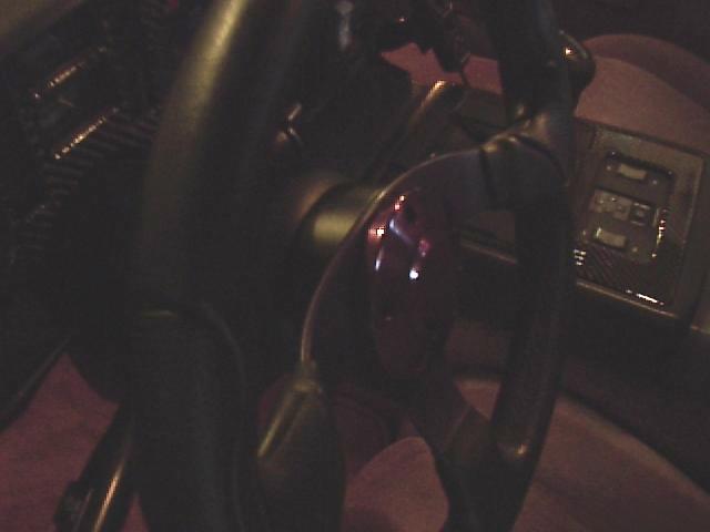

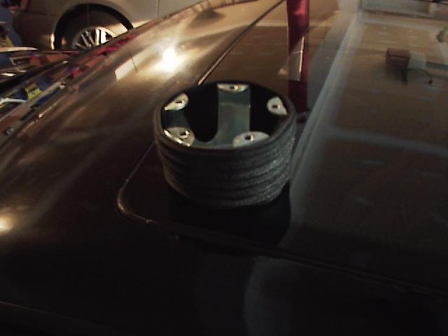

If you like your "stock" wheel so much, why not just get a reconditioned one? They have them at www.fierostore.com A lot of the aftermarket steering wheels have almost no dish, what makes them stick out is the adapter you need to use to be able to install them. Make sure you get the shortest adapter. I have a 1 inch on my Grant Evolution steering wheel. I'll try to post a picture later.
Here is the old adapter, it was almost 3 inches.
