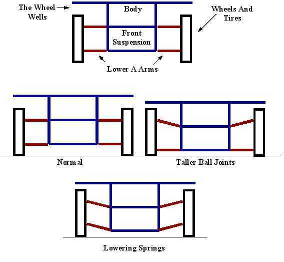

As I understand, the lower part of the spindle would be 1" closer to the lower control arm. Am I correctt? What, if any, effect on the upper control arm? Would the spring compression be decreased by the same 1 inch?
FierOmar
litespd
Posts: 8128
From: No where you want to be
Registered: Aug 99
Total ratings: 176
Report this Post02-01-2004 05:15 PM Click Here to See the Profile for litespdSend a Private Message to litespdDirect Link to This Post
Omar, as I understand it, following the link to the thread that Rodney posted, the lower part of the spindle will be placed further away from the lower control arm. The angle of the UPPER control arm will change...not sure if this pic will work or not...
If this pic works, it will explain it. If it doesn't, check out Rodney's post above, and click on the link...the pic shows up in that archived thread.
Your upper control arm will be closer to it's upward limit of travel, but I don't think that 1" will make that much difference...certainly no more difference than using lowering springs. However, your spring won't be compressed as much at rest, which makes me wonder how it will perform under compression/rebound. Reading in the thread, though, the one gentleman that has perfomed the modification using the Cadillac ball joints says that if anything, the suspension geometry is improved by doing it, and the stock ride quality is retained. It seems to be an inexpensive alternative to drop spindles. My concern might be the strength of the ball joint.
