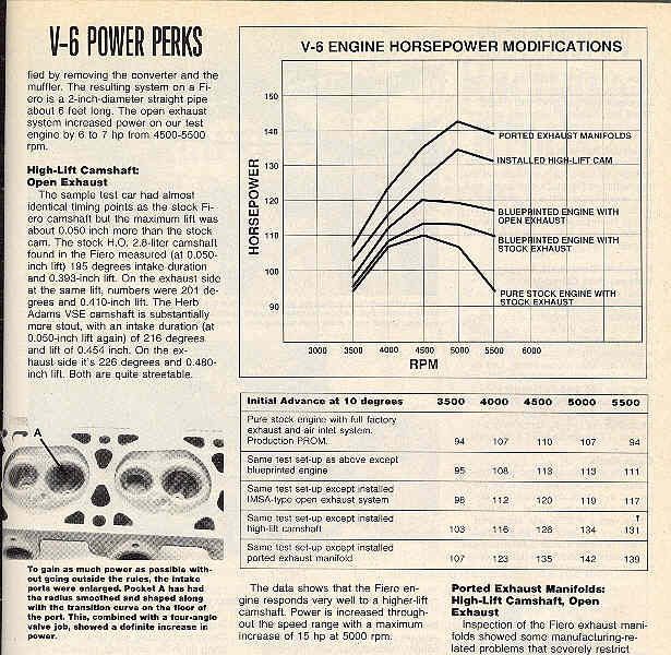

There's many who believe that the computer can't take a big cam without having running problems. Here's an article from Car Craft magazine that did some modifications to a Fiero V6 back in 1989 proving that the Fiero not only can run a high lift cam but responds well to it!
You'll note that they actually mention how well the Fiero responds to the high lift cam. The cam they used in this test is almost exactly identical to the Crane H-272 cam.
For comparison, the Crane H-272 cam specs are as follows: duration at .050; 216 intake and 228 exh (cam in the test above has 226 exh duration and the same intake duration) Lift for the Crane H-272 is; .454 intake and .480 exhaust which is identical to the one in the test above.
I've known about this article for some time now but i've not been able to get my hands on and original copy until just recently. Many thanks to Minngreengt for steering me towards a place that sells old magazines!
Also of interest; they found 8 HP at 5,000 rpms with ported exhaust manifolds and 7 HP with an open exhaust system.

wow! impressive chart! going from stock 110 hp's peak to blueprinted/hi-liftcam/ported exhaust at 142 hp's peak, with a min gain of 15 hp's all around.

They tested everything one piece at a time so i would think you'll find a pretty close gain without the other mods BUT you should at least do the ported manifolds. They don't cost much and they obviously improve things greatly. Darrell Morse does them for a very reasonable price. Here's Darrell website addy: http://www.diginostics.com/Darrell_Morse/darrell_morse.html
One thing that i would suggest that they didn't do is to use an adjustable fuel pressure regulator. This can help you fine tune your mods and possibly even gain more power.
BTW the Borla's been dyno tested to give 7 HP to the stock engine.

That looks like the data from Herb Adam's "Fiero Kts - All Fired Up!" article from Kit Car From waayy back. He didn't even bore the throttle body. Rules prohibited that sorta thing.

Yes, it is Herbs Fiero but he never really mentioned what the cam specs were in his article. I have that one too in this pile of Fiero info in my drawer.

The point of the article is to show that you don't have to settle for the small 2030 cam if you don't want to. Many believe that it's as big as you can get without driving the computer crazy and this is obviously not the case. The 2030 cam doesn't make any big numbers or big differences becuase it is small. It certainly is better then the stock version and you will gain some power but it's not big enough to expect much from.
If you use an adjustable fuel pressure regulator you will eliminate the lean condition and idle problems if you adjust it properly to compensate for the mods you've done.
Emissions are another issue and you are correct that they do require a smaller cam although you can esentially cheat the test with an adjustable regulator by leaning it out too. Not that i'd suggest doing such a thing of course. O

The 2030 cams specs are as follows: duration at .050: 204 intake and 214 exhaust.
.423 intake lift and .423 exh lift.
Stock Fiero cam is: duration at .050: 196 intake and 203 exh.
.394 intake lift and .410 exh lift.
Not a big difference really but some.
Here's the Crane H-272 again for comparison: duration at .050: 216 intake and 228 exh.
.454 intake lift and .480 exh. lift. This is almost identical to the cam they used in the test which showed a max gain of 15 HP at 5k RPMs. This is obviously a bigger cam then the 2030 cam so obviouly the 2030 cam would produce far less gain.
I'm not saying this is the best cam for every occasion but it's a good choice for someone with a manual trans, no emissions, and who's looking for a nice power gain.
The reason i mention a manual trans is twofold; first an auto trans is more sensative to a bigger cam and second; the bigger cam moves the rpm range upwards which is more difficult for an auto to take advantage of where as a stick allows you to change your driving habits, rpm launch, etc to make the best of that new power.

Good article. Did Herb say what they used for springs, and what they did for rockers and studs to handle the increased return pressure to handle float and upper rpms?

Herb didn't write the article, Car Craft did. Neither mentioned which springs they used but, today, you can use the matching Crane springs that are recomended for that identicle cam. You MUST make sure the recomended springs are installed at the correct hight though or you will experience bind. Crane also makes performance locks and retainers etc to go along with that cam.
As for rockers, there's no mention of that either but i would guess that since this article was done in 89 they didn't have any roller rockers available at the time and probably used the stock ones.
[This message has been edited by Dave Gunsul (edited 01-15-2004).]

If your going to go that large of a cam, it'd be a good time to retro fit the heads with 3/4" studs and use SBC roller rockers.
Good article,
