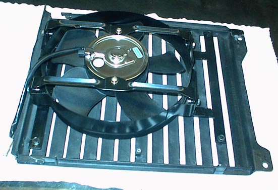

I have both the stock blower fan and also added a 10" thin-line fan to the left vent grate. It is wired to come on any time the key is on. I have found that it must do something because before I put this fan on, the back window would get very warm to the touch and now it just gets luke-warm. Even though I have a 3800 turbo, I strongly suggest anyone running a modded Fiero use one. Getting rid of a little extra heat never hurt anything.
If you decide to install your own grate-vent fan, be sure to configure it so it takes air from the engine compartment and blows it up and out. Because of the aerodynamic nature of the Fiero, there is a low pressure area that forms behind the back window when the car is in motion so you don't want to fight the natural tendancy of air from the engine compartment trying to come out the top of the grate while going down the road.

Do you guys have any pictures of the fan in grill area? Sounds interesting!
Hey Gary, this is the best picture I could find. I have lightened it to try to better show the fan. The fan used is your typical aftermarket, thin-line 10" electric fan. My stock grates had some guards riveted to the underside that I removed and then attached the fan using some of the rivet bosses and screws that come in from the front of the grate.
Next time I get a chance I will try to get some better pics of the fan off the car so you can see how it is mounted.
