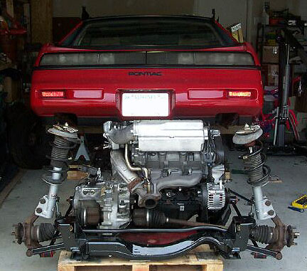

I have a chassis that I would like to clean and protect. It is mainly rust free, except that annoying battery tray. The rails are clean, the cradle is immaculate, the trunk area is spotless. As it sits now, I have the car entirely disassembled, and the chassis is ready for my attention. How should I go about preping it? What should I use? A friend of mine painted his cradle with POR15, which I am not really familiar with. I priced it, and it isn't expensive. What do you think? What paint have you used in the past?

I am in the process of painting my space frame and engine compartment, while removing some rust holes and replacing the upper frame rails. I have completed my cradle using POR-15 and then top-coating it with gloss black Dupli-color paint. I would definately reccomend using the POR-15, it dries hard as nails, is sandable before top-coating and is really easy to apply. I also have used it with fiberglass mat to repair some rust holes in my trunk and wheel house areas. In this application it worked very well and again dried hard as a rock. I am documenting my rust removal with photos and will post them here when I am finished. It sounds like you will have less work to do than I did. If you have not been to their web site, you should check it out. I believe it is porstore.com all of thier products are availabe there. I used the Metal-Ready prep solution and POR-15 in black and followed their instructions to apply. Now some words of caution, Do not get this stuff on your skin it will not come off, I have several very small dots of black on my arms etc. that I am going to have for a while, secondly POR-15 takes about 4-5 hours to dry, then they reccomend a second coat so you will need to do it when you have time, I found that the cheapest, plastic bristle paint brushes work the best to apply, natural bristles seemed to "gum up" so do not waste your money on good brushes, there is no way to clean them and you will have to throw them away anyhow. I bought 1 quart and have done my cradle, most of my engine compartment, fiberglassed in the holes and also did my rear control arms and I still have maybe 1/4th of the quart left, Glassing in the holes used a lot of the product or I would still have 1/2 a quart. This stuff does go along way and you could probably do the whole car with 3 quarts.
