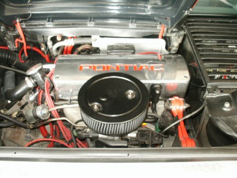

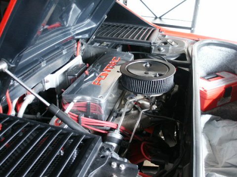

Here are some pics of the SD valve cover on my 84.
Pat
