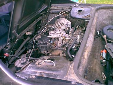

Well the 4.9 is finally in. Now just have to get the wiring and hoses (A/C, trans and engine coolers)done. I hope to have in done within the next 2 weeks
I have plenty of room between the engine and lid. There was no need to cut the hinges. The battery will move to the front to help weight balance.

On 8-24-03 I said I hope to have it done in 2 weeks (HA HA HA HA).
Well I started it up today (2 months - 2 weeks....close) without exhaust.
I had to build a new bypass module as the old one was damaged after being thrown around in boxes over the last 8 months.
It looks bad, but all the connections are soldered and heatshrink wrapped. Now it is time to get busy with cable ties.
The white block is the bypass I breadboarded last night. Since it worked fine, I will move it all to a PCB tonight.

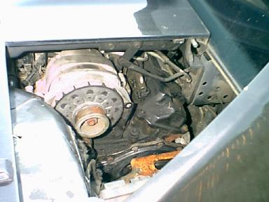

More cable ties needed here. The inline radiator filler is off a Mazda RX7. The oil cooler is off a Chevy diesel PU.
I used a timing belt tensioner off a ford 2.3 to adjust the belt. The idler is aslo from a 2.3.
I set out to build this on a budget, and everytime I see a pulley or bracket etc, I think how can I use that.
