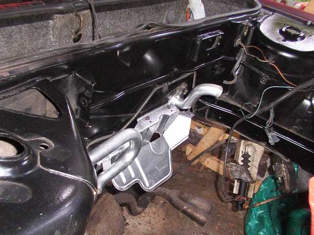

Well the cars up on stands, would this be a good time to install my new ebrake cable?
Uhhh my battery tray is kinda toast... anyone done anything to fix or replace it?
Any other tips on stuff to do while the whole backend is apart, would be appreciated.

Change the steering stabilizer, check the cooling hoses; might see if you can reach the spark plugs a little better, if they need changing.

Drop your fuel tank & install new hoses!
Mine are toast.

your not serious about the spark plugs I hope. Take your engine cover off to change the plugs, you will get done faster with it off.

There is a new tray available from the Fiero Store. We installed one on our 85Se looks like the original

I had heard that the spark plugs were easier to take out if you were able to get to them from underneath, but I've just done it from the top of the engine.

They are easier to get off from the top. From below, the exhaust manifold is in the way (and that is assuming you don't also have the AC system in the way).

wait, I remember now - take the engine cover off, then flip the car upside down
then you can lie on your back while you change your plugs. :c)
back to your question: how do your CV boots look?

Ken...what? Why the would you take off the cover? If you can stand doing it without being able to see the rear plugs, you can do it easily without removing anything. Just snake your hand over the intake hose and reach back there, you can do the whole job by feel. All I needed was a few extensions and a u-joint, and I was golden. You can get the passenger side one by just reaching around over there too. The center one is reachable from either side. It is alot easier if you sit on the tail light housing, with legs/feet in the trunk. My best time is 8 minutes for all 6!

Will look at fiero store... about ebrakes though... is there anything I can do to make it easier to pull and release?
Oh the motor is standing outside car so its very easy to replace plugs, but already did em in car by feel(let car cool down a while).

If the motor is out of the car, clean up the engine bay!
