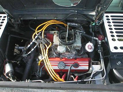

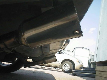

Heres the only two pics I have handy:
Sounds good. lol. umm low burbly like a healthy v8 minus 2 cyl
