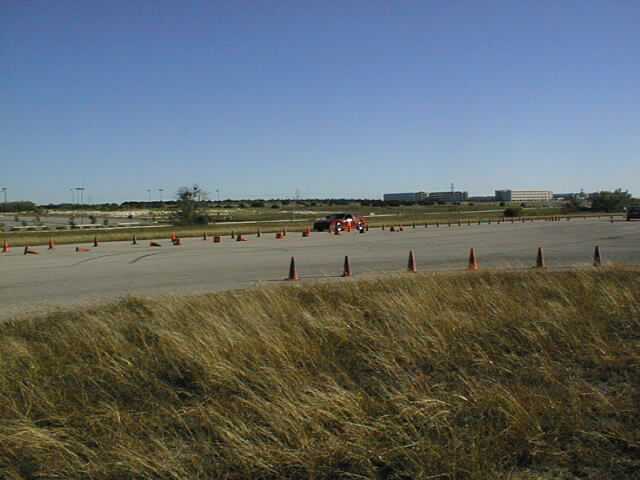

revin
Posts: 8684
From: Pville, TX
Total ratings: 234
Report this Post08-05-2003 12:23 AM Click Here to See the Profile for revinSend a Private Message to revinDirect Link to This Post
Sorry it is so far away...A good camera man is hard to find
Kevin kevin kevin... its not so much finding a good camera man... its more-so finding a camera man with the cojones to be close to the track when YOURE driving

Check with your local SCCA region http://www.texasscca.org/ , and find out what they offer.
Autocrossing is fun, however the money I have put into it this year (and not having run) would have bought me a used IT racer.
hoop
