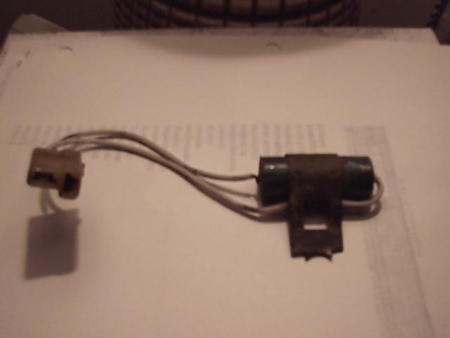

I had a similar problem on an 85 SE V6 that I used to own. Turned out the catalytic converter was clogged. The car would spit and stumble if I tried to get it above roughly 2000 RPM.
I would check the fuel filter first, then have a look at the cat.
The tach jumping around is a sign of a bad tach filter. If this part goes back it will short the coil directly to ground. It can also kill your coil. Try unplugging it and see if the car will run. Try swapping out the ignition module also, just as a precaution. The tach filter looks like this.

OK, GOOD news! First of all thanks alot for the suggestions. Actually what happened was i must have broke a tab off of one of the connectors for the coil (the one for the tach ) and that would explain the tach going nuts, it also made the car not able to start. Took care of that temporarily with a little bit of duct tape (more uses everyday, right??). However that doesnt solvethe accelerating problems. Ive got a "Spare parts" car (its really just another gt that has a blown tranny) and im going to swap the exhaust tomorrow, and if it runs fine, then we all know what the problem was! Ill get back to you guys. Anyone with more suggestions??-i STILL would appreciate it!
