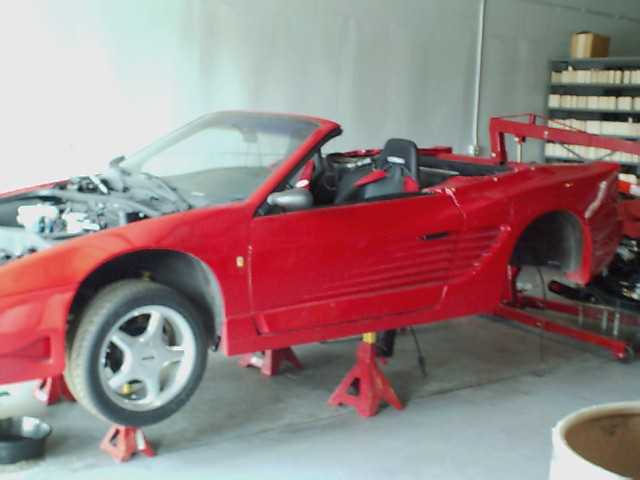

Does anyone have any pics of what the bottom of the car might look like? Does this new metal go over the exhaust? How would you get to anything if theres another frame there?

I dunno what this fascination is with x frames. They are not needed. I spoke with an automotive engineer on this matter and strengthening the sills, a pillars and b pillars is enough to reinforce the car. To go all the way on the Fiero plate the fuel tank tunnel from the inside of the car as well. Those mods will give you a stronger Fiero than a 2X1 X frame and also better ground clearance.

No X-Frame here, just 1" square down the frame rails and angled up into the rear fender wells.

A bolt-on x-frame will help reduce the amount of twist experienced by the spaceframe during loading/unloading at any one wheel by providing at least some strong link between opposite sides/ends of the car. Chopping the roof frame rails off (ala targa-style) leaves no structure up top for the spaceframe to resist bending and torsion. Granted, it isn't a highly-efficient method, but it improves the strength of structures that can't be easily modified in other ways. The BIG question is, would it improve body strength enough to be noticeable? I think the Ford Mustang convertible (1st-generation Fox platform) used this method, and may still be using it on the current car.
The best method to reduce bending would be to increase the height of the sills, but that isn't easy in the Fiero because of it's low ground clearance on the bottom end, and the rocker panels and doors on the top end. The next best thing would be as you suggested, Aus: Use the center tunnel to increase rigidity, preferrably inside the cabin. It's the highest structural point on the car connecting front and rear halves after the roof frame.
I'm not sure about strengthening the a-pillar or b-pillar areas. What would this improve?
Any way you look at it, you'll end up adding a lot of weight down low trying to recreate the relatively lightweight structure lost up top. For any Fiero targa, it's all a question of how you like your pasta: Al-dente or mush?
