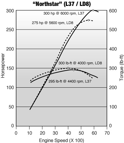

Please do. I'm curious. How does it consider shift times & wheel spin? For instance, California Kid has recorded his best acceleration times starting with his Getrag in 2nd gear, eliminating the 1-2 shift and reducing wheel spin off the line. His engine has a lot more torque than a N*, but the principle is the same.
This is for the MY2K and newer engines: http://www.gm.com/automotive/gmpowertrain/engines/northstar/apps/nstar.htm
This is for the older engines:
As you can see, much to Artherd's chagrin, the newer engines have slightly more low RPM torque than the older ones.
Just use a stock Fiero V6 5 speed weight. The difference betweent the 2.8 and N* is much less than the weight of a tank of gas.
I weigh 235 and am running 255/50-16's if you really want to split hairs.
