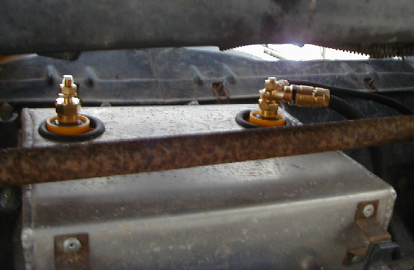

What seems like a very long time ago, I installed a West Coast front mount battery kit into my V8 Fiero. Well, I got in a hurry towards the end of the job when I was running the wires, plus the spare didn't fit right afterwards. Yesterday, I bought a new battery and then I spent several hours today fixing things.
Here is what it looks like with the spare tire removed. I got a pretty yellar battery from Wal-Mart. If you do an archive search, you'll find my original post that documented part one of the story.
Since the box is aluminum, I took some vacuum hose, split it and then glued it around the post holes (see second pic of the underneath side). I used some fancy gold screw-in battery posts and cable fittings. The positive cable is not connected yet in the pic.
I'm much happier now. Finally finished the job off right. Seems to work great. I used 2 gauge welding wire to run the positive cable to the starter and for the negative cable to the engine block. I also used a short 6 gauge wire for a second negative cable from the battery to the frame. I also have a ground from the engine to the frame. I wanted to make sure everything was well grounded.

Pretty neat hook up. Do those batteries come in mauve by any chance?? Them fancy gold connectors contrast well with that is THAT rusty thing in the lower pic???? I ain't got one of those. Got a spare one you want to sell??? I'll pay cash on the barrelhead for it.
Seriously, it looks good. Exactly where did you run the cables?? I know, I know. do a search & I'll find out. (sets time machine for "a very long time ago".
Edit-Do these newer batteries emit noxious sulphuric fumes that might cause corrosion problems in a closed space like the front compartment??

That rusty thing is the sway bar. Got another rusty one on my parts car if you really want one... lol. This is a functional driver, not a show car.
I ran each battery cable along the A/C lines which are on either of the center hump. There are little bracket clamps that hold the lines in place, so I removed them and slipped the cables into position, then replaced the clamps. I also used a few nylon wire ties to keep the cables up out of the way. Seems very sanitary with the cables tucked up there. You have to crawl all the way under the car to even see the cables.
There are completely sealed batteries available (gel cell I think), like the Optima brand that racers use. These are very expensive and are usually top post batteries which won't work in this setup. There really isn't much to corrode in the trunk. Maybe the spare rim. The spare tire well is plastic. There is a drain hole in the bottom and of course the two holes for the side posts in the box, so it's not sealed up in there.

OK, a pic from below.. I see it now that I turned the monitor upside down. I got a stabilizer bar already so I guess you lost a sale. I might have to try that, since I worry about people 'borrowing' my battery after ripping the vent off the 84. (I put '85 vents on it) Good job

The neat thing about those gold Streetwire connectors is that you can run multiple wires from each terminal. It's hard to see in that pic because the negative cables are black, but I have two cables (one 2 gauge and one 6 gauge) on the terminal. I also have two positive cables (one 2 gauge to the starter and one 8 gauge to the stereo amp).
The total cost of about $150 includes the battery box kit, 20 ft. of 2 gauge welding wire, 2 ft. of 6 gauge wire, 10 ft. of 8 gauge wire, 1 ft. of vacuum hose, all the gold Streetwire connectors, and misc. hardware. This mod could probably be done much cheaper. I've also installed in the engine compartment, a battery cut-off switch thing from my Dad's old RV, so I can easily kill the power when I'm working on the car.
