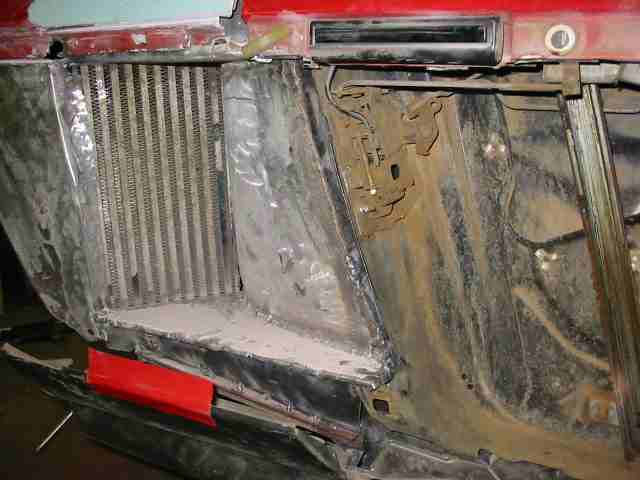

I got one - Lots of work though

Well son of a b...
How the heck did you do that?
We need more info, and tons more pics!

WOW!!! thats a neat setup!
