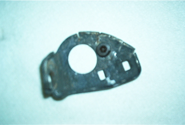

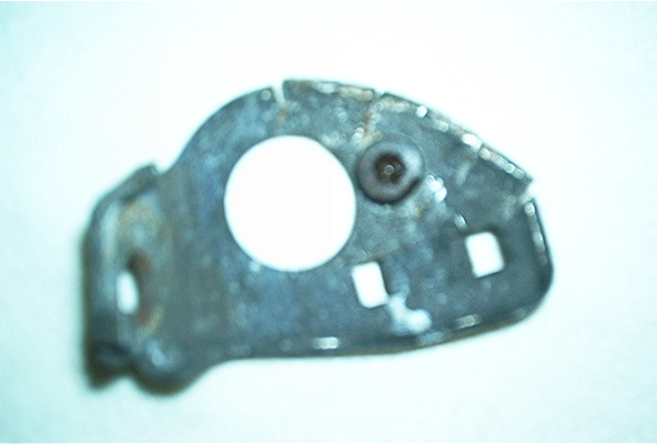

I have a beat up one you can pickup sat morning if you want. heres a pic, someone tryed hacksawing parts to get off in a yard, finally gave up. it pulled right off..
this will work no probs, just to get you by for awhile until you can pull one from a yard.
I'll PM my home number.
