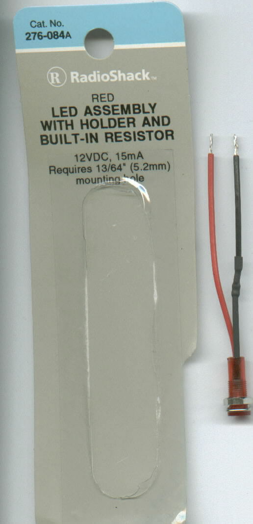

Does anybody know where I can get a "single" red LED rated for 12volts. I want to install a couple (about 4) of them that will be on 24/7.

And remember that LED's are light emmiting DIODES. They operate on current, not an actual voltage. There is a max and min voltage range, but the main thing is current. That's why you'll see "15ma" on the package. If you were to hook it straight to a battery, the current would go WAY over that in about a millisecond, and it'd go pop. That's why you need a resistor in series with it.

The two biggest specs you need to worry about, Forward Current = If and Forward Voltage = Vf.
If you exceed the current limit the pn junction will get to hot and will fail.
The current is regulated by adding an inseries resistance. To determine the correct resistance value you just plug into an equation.
Vin= Power supply, probably 12V in your case.
R= (Vin-Vf)/If
The resistor must have the correct wattage rating. (Vin-Vf) * If. Make sure your resistor has a larger wattage rating then this or it will smoke and could be a fire hazard.
VIP = measure your battery (while the car is running) if you are using 12V supply! Cars battery voltage can be much higher then 12V. You may want to use a zener diode and resistor to better regulate your LED supply, but this is probably over kill.
Some LEDs have the resistance built in them so you do not have to worry about it. Most voltages you would be dealing with are covered 5V, 12V ect...

LED's? Radio Shack has em by the boatload, with resistors built in, all current-voltage & types. Just put some in some pwr window switches.
