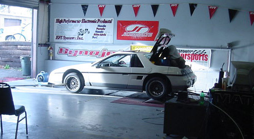

ok... having done this a few times we drove straight to the dyno before making ANY real changes. yeah we pulled the cruise off and cleaned the intake and a few other things but no HUGE changes. well it had 1 year old AC plugs (recipt in the car-mileage unknown) and dynoed at 116.2hp/144.6lbft, knowing that NGK have always been better we swap them out with NGK UR5s and guess what.. it redynoed at 124.5hp/153.1lbft and increase of 8.3hp and 8.5lbft!! just with a spark plug change...
i hope the new Brisk spark plugs make just as much difference!
oh yeah... heres a pic of him all strapped down...

and he did a 0-60 run.. 6.49 seconds...
