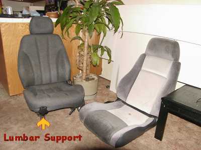

Got myself a minty set of 1997 Sunfire buckets yesterday. Swapping involves nothing more than changing over the tracks, no drilling or nothing. I know people wanted to see what they look like so here goes.
New and old side by side

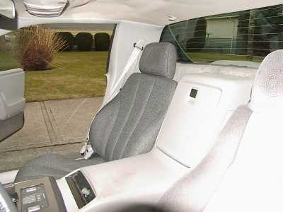

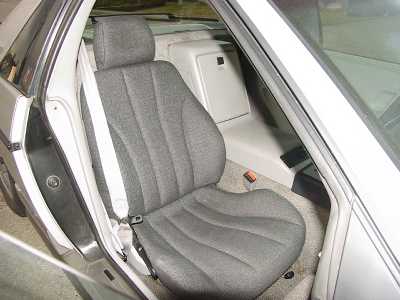

New, Installed
another shot
Only had time to do one tonight. I lost the headrest speakers, but gained lumbar support. A very good fit by the way.

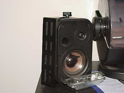

I'm going to try and install these speakers for now, they are my computer monitor units at this time, but have all the hardware I need.

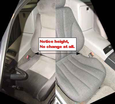

What is the height difference betwen the two? I would like to have shorter seats in my replica...can you help ? The lumbar support sounds sweet.

You won't lose any leg room OR headroom with these as long as you use the Fiero seat hardware with them. They look like they were made for the car. When I measured them they were one inch wider at the front of the base then the Fiero's, but it's not noticable at all when they are in. This is not the best pic but it shows where the bottom of the base sits with both seats. I'm 6 feet tall and still have a good few inches before I'm touching the ceiling.

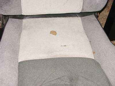

I got tired of looking at this tiny hole in the passenger seat, wasn't much, but the rest of the car is very very nice. The cost of getting my old one fixed or getiing these was worlds apart

Mine cost $150.00 CDN from the wreckers. They are a perfect fit and are much more comfortable than the Fiero originals. They are very easy to install(I did mine myself). Well, it did help to use my husbands impact gun on them - goes much faster I learned
