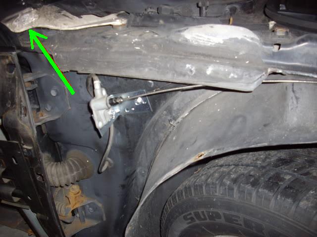

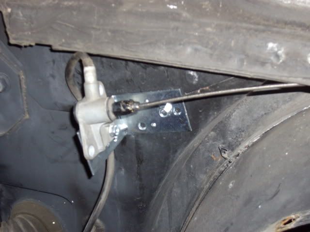

      What do you guys think of this? I relocated the antenna into the fender. The radio still does work and im having the body shop fill in the hole on the fender. I dont know if i can take credit for this idea but if no one has done it than so be it .

87antuzzi (krisantuzzi@vzw.blackberry.net) MSG #12, 03-03-2010 05:09 AM

randye (randy@enerson1.com) MSG #32, 03-04-2010 02:01 AM
Originally posted by dudewithoutfiero:
jimmyS did his but he took the antenna and put it inbetween the a pillar and the frame. he gets good reception better than when he had it mounted like pkids
I think I may have suggested that to Jimmy after I did mine that way. (or vice - versa. I really can't remember now...)
All I did was trim away most of the antenna base, leaving the coax cable connection intact, and then shoved it into the space between the steel frame and the fiberglass in the A-pillar.
There's plenty of that "black goo", (urethane sealant), in there to hold the antenna in place with no rattles.
I did have to cut a small, (3/8" - 1/2") notch in the steel frame to clear the antenna base
This method places the antenna in a more upright position which I think is better than laying it down horizontally under the fender.
My radio reception is great.

IwannaIRM (swags33@cableone.net) MSG #35, 03-04-2010 11:35 AM
      As others have stated, nope you're not the first. And I doubt you will be the last. The relocated antenna under the fender works great. Mine was done about 2 years ago. I have some work-in-progress pics but can't post from work. Although, I can link to finished mod pics.
One thing I did was tie my antenna tip down with copper wire and add some rubber grommets so the antenna wouldn't rub against the frame metal or body plastic and provide any additional rubbing or bouncing noises.
rogergarrison (fastandred@hotmail.com) MSG #36, 03-04-2010 01:43 PM
      Technically, the base of the antenna is grounded to the car and the center post is supposed to be isolated (its mounted in plastic). By putting wire around the mast and fastening it to metal you ground it. May work fine, just pointing it out, might work better if you used a piece of plastic to attach the mast end,
