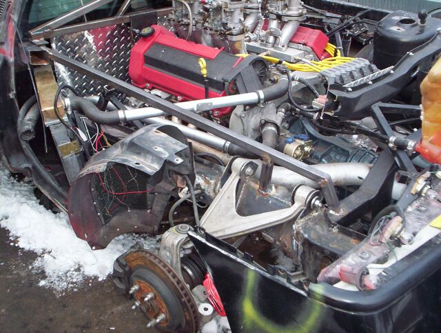

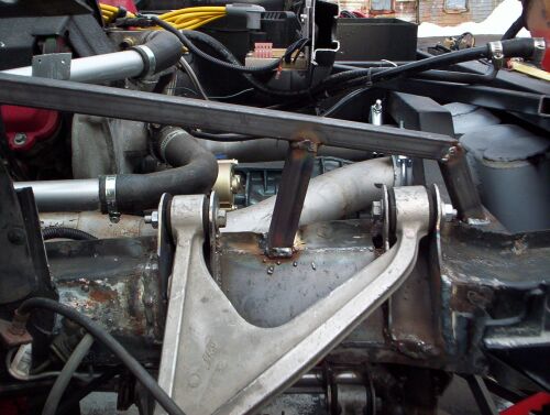

bubbajoexxx (bubbajoexx@sympatico.ca) MSG #36, 10-04-2003 12:03 AM
      here are some pics of the process so far

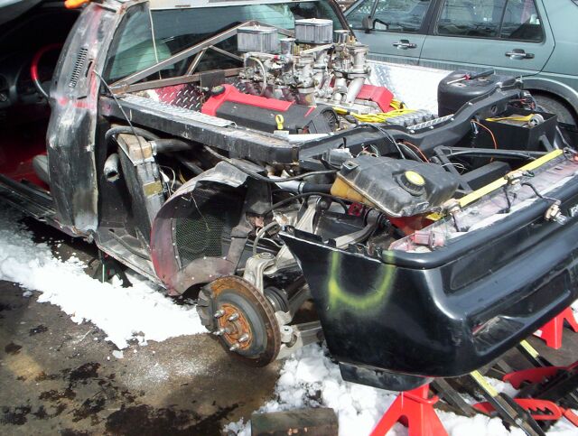

bubbajoexxx (bubbajoexx@sympatico.ca) MSG #37, 10-04-2003 12:11 AM

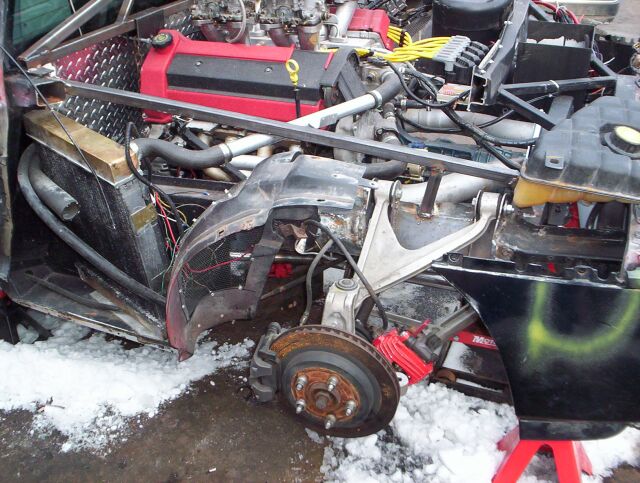

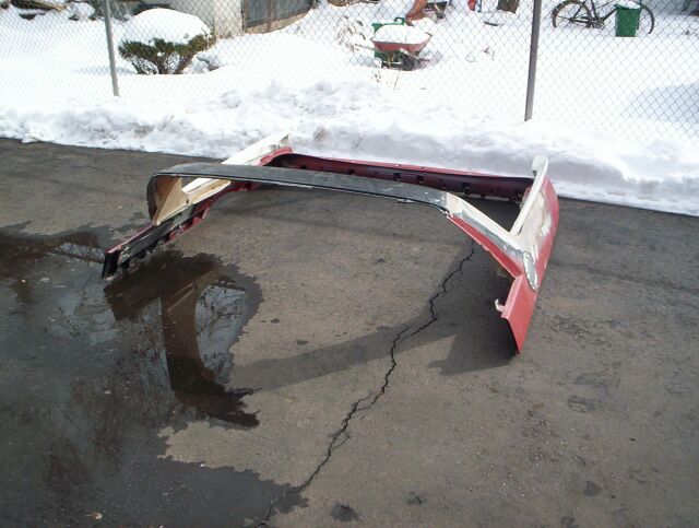

bubbajoexxx (bubbajoexx@sympatico.ca) MSG #45, 10-04-2003 03:43 PM
      here are some more

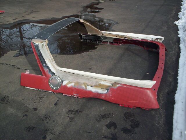

      thank you this is the hardest part to make the upper section will be made from 2 more rear sections and glass fill
bubbajoexxx (bubbajoexx@sympatico.ca) MSG #48, 10-04-2003 06:39 PM
as you can see the chassie is well reinforced and the new space will hold the new rads one on each side

bubbajoexxx (bubbajoexx@sympatico.ca) MSG #54, 10-05-2003 03:30 PM
      started mock up of the side pannels that will be replaced with scoops once the lower rocker extentions are complete

bubbajoexxx (bubbajoexx@sympatico.ca) MSG #74, 10-11-2003 07:12 PM
      rear is now framed and glassed and rear of roof attached now have to fill in the roof and part of the sides so windows can be installed

bubbajoexxx (bubbajoexx@sympatico.ca) MSG #87, 10-14-2003 06:40 PM
      rear section removed from the car as you can see its not part of the car

yosemitefieros MSG #89, 10-15-2003 12:23 PM
bubbajoexxx, what thickness metal stock did you use for the extensions? Also, what did you use specifically on the cradle?
Gary
bubbajoexxx (bubbajoexx@sympatico.ca) MSG #90, 10-15-2003 04:28 PM
      1/8 on extention and 100 wall on upper rails and cross bars and 3/16 on the cradle

bubbajoexxx (bubbajoexx@sympatico.ca) MSG #119, 10-23-2003 06:33 PM
      latest update scoops on the car and they fit perfect
should provide plenty of air for the side mounted rads

bubbajoexxx (bubbajoexx@sympatico.ca) MSG #136, 10-28-2003 03:20 PM
fuel system done except for the other stacks (on back order) time to go back to fiberglassing and the ichies while I wait for more parts

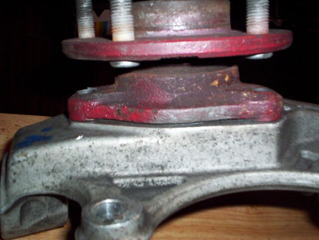

      phenolic spacers custom cut to isolate the carbs from engine heat

bubbajoexxx (bubbajoexx@sympatico.ca) MSG #166, 11-15-2003 08:49 PM
these are the latest pics of the body so far
engine dist pics will be posted on friday when the parts are back from the machine shop

      as you can see here have started to make up the trans adaptor
out of 3/4 6061-T6 aluminum
in this pic you can see where the stock fiero slave has been mounted to actuate the porsche clutch arm finish trimming of the adaptor will be completed when all the nessesary components are mounted
space is a premmium with the water pump so some minor trimming was requiered
Bob and I spent the last 2 days getting this far work is slow but I will be getting there soon

bubbajoexxx (bubbajoexx@sympatico.ca) MSG #247, 02-22-2004 07:23 PM
      started making the headers. they seem to be coming alone fine as you can see
[This message has been edited by bubbajoexxx (edited 02-22-2004).]

bubbajoexxx (bubbajoexx@sympatico.ca) MSG #249, 02-24-2004 11:17 PM
started to build the exhaust piping for the engine all 3" to 5 inch supertraps at the exit .where it will come out is where the rear plate used to be

bubbajoexxx (bubbajoexx@sympatico.ca) MSG #251, 02-24-2004 11:35 PM
      got to get some free flow from them pipes

bubbajoexxx (bubbajoexx@sympatico.ca) MSG #265, 02-25-2004 09:30 PM
      I try to use 3" pipe on all of my cars as room permits cant always get it in there.
crzyone
I want to get CHRFAB,s cams if money is OK.
By the way here is how far I am on the exhaust so far.
excuse the smoke I just finished welding some pieces
and the shop is only 10X10 not very big

bubbajoexxx (bubbajoexx@sympatico.ca) MSG #269, 02-27-2004 10:32 PM
      exhaust almost done just 1 supertrrap left to finish here are some shots
trapps are 5" in diamiter
the 3 inch tubing ia flush welded so there are no restrictions in the flow

bubbajoexxx (bubbajoexx@sympatico.ca) MSG #273, 03-12-2004 07:04 PM

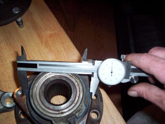

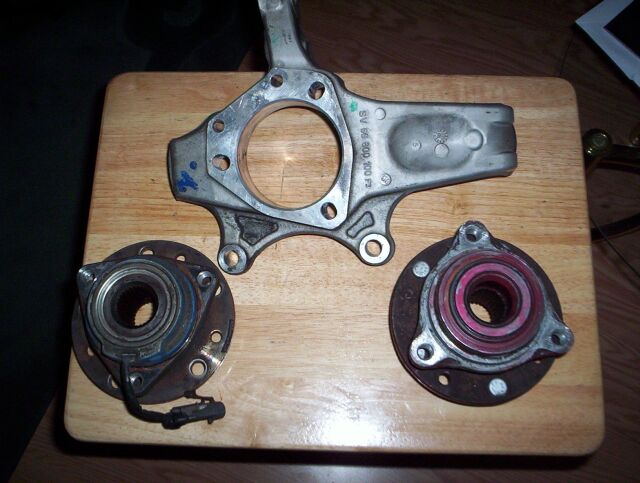

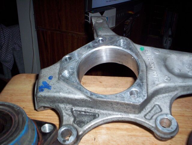

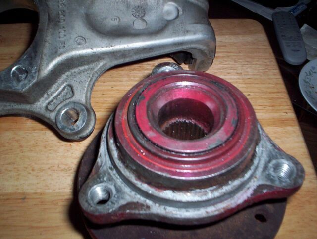

      newest parts to be added Large 12 inch brakes from an 85 Corvette and its is the easest brake swap any one can do if you have a drill press
these pieces are all you need to do the swap 2 consentric rings for the rotors to keep them centered
and 2 1X4.5x2.5 piece of 7/8 inch mild steel for the coliper adapter

      16 and up only 15's are a no go the 16 inch wheels clear by 3/4 of an inch on inside diam.
crzyone (crzyone@cablerocket.com) MSG #281, 03-13-2004 07:09 PM
      Joe, you get a big + from me, that is awesome. Thanks for the info on the brake swap!
Master Tuner Akimoto MSG #282, 03-13-2004 08:06 PM
      Joe PM sent .
bubbajoexxx (bubbajoexx@sympatico.ca) MSG #283, 03-13-2004 09:14 PM

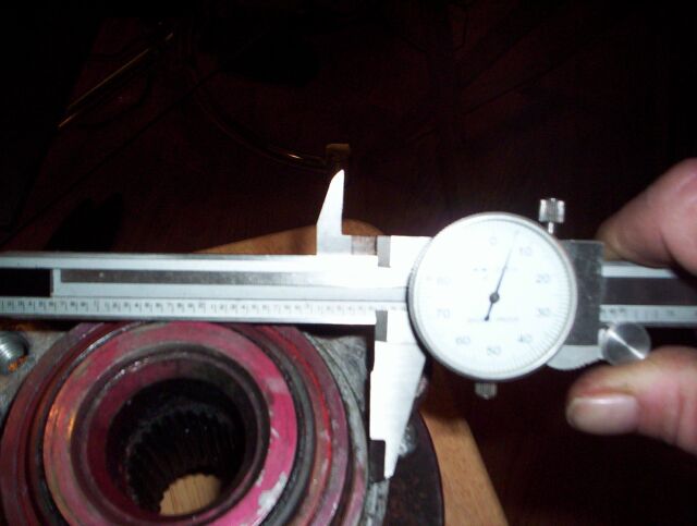

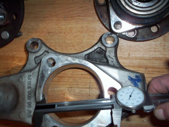

      here are some of the sizes I will post the rest tomorrow
consentic rings front outside diam. 2.785 inside diam. 2.240
" " rear outside diam.2.785 inside diam. 2.255
drill spindels to 7/16
tap drill size 13/32 for use with the 12mm 1.75 x 30mm long cap screws
block diamentions 1"x 2.5' x 4.5' long 7/8" thick nothing less or the adapters are no good and caliper brackets will rub this uses no washers to line things up

      Installation
Start buy undoing the brake hose be sure to pinch it off with Vise Grips
to keep from letting all the fuid from running out into your work area
remove the rotor and then remove the old caliper bracket using a 19mm socket and rachet and remove the backing plate
the area I'm pointing to must be smoothed and leveled using a grinder or heavy file. This is to make a surface for the adapter
to bolt to and drill out the old holes to 12mm (17/32) as the old threads are no longer used
This is a comparison of the two setups the stock on the bottom and the Vette on top
the rotors are 88 and the calipers and brakets are 84 to 87
part1
bubbajoexxx (bubbajoexx@sympatico.ca) MSG #322, 03-19-2004 06:02 PM
This is how the finished spindle should look after drilling and leveling out and a little cleaning
install the cut hub and new rotor then bolt the adaptor to the brake bracket as seen above using 12mmX1.75 cap screws
with the adapter and bracket together slip the pieces over the rotor in the fashion
displayed in the above 3 pic and the rotate it into the bolting position
partn 3
[This message has been edited by bubbajoexxx (edited 03-19-2004).]
smokinjoefission (fiero@smokinjoefission.com) MSG #323, 03-19-2004 06:09 PM
      Bubba, that is awesome! A + for you, more if I could.
Two questions: The 'vette rotors: do they come with the same bolt pattern as the Fiero, or do those need to be drilled? I see that they seem to have an extra set of 5 holes in the rotor.
Other than cutting off the Fiero rotor itself, does it need to be machined like other brake conversions?
Thanks for taking the time to share this brake upgrade!
bubbajoexxx (bubbajoexx@sympatico.ca) MSG #324, 03-19-2004 06:10 PM
and bolt it up with the same 12mmX1.75 cap screws then install the pads as you normaly would
Now bleed the front brakes install the wheel and your done
note the clearance on the 16" inch wheels
DONE

      Bubbajoexxx, was there a reason you went with the stock Fiero bolt pattern, since you went this far why not stick with the Vett bolt pattern for a wider veriety of rim choices?
bubbajoexxx (bubbajoexx@sympatico.ca) MSG #330, 03-19-2004 11:09 PM
      set themup like this to show everone how it is done Have new hubs comming with the 5X43/4 bolt circle for the project

      Still not clear on how the consentric ring comes into play here, do you have a picture as to how you are useing it?
fierohobby MSG #334, 03-22-2004 10:01 AM
      OH10 -
Take a closer look at the 3 pix showing the installation of the Vette caliper bracket. The ring is there, between the Fiero hub and the Vette rotor. Apparently acts as a "spacer".
fh
Master Tuner Akimoto MSG #335, 03-22-2004 10:49 AM
      The concentric ring is what goes into the center hole of the rotor and make up the space to keep the wheel from running in a out of round pattern.

bubbajoexxx (bubbajoexx@sympatico.ca) MSG #337, 03-23-2004 12:07 AM
if you look close you will see the consentric ring between the rotor and the hub without it you can not center the rotor
rim inside diamiter is 15 11/16 " then tapers down to 15 at the face
working on the rear just waiting for the caliper brackets to come in it will only require a bracket simmilar to the front to attach the caliper and a bracket bolted to the stut attaching bolts for the mecanical ebrake caliper everthing is linning up great will be easy to do once I get the rest of the parts

      for those who want to see the corvair hubs installed on the fiero spindles us this link
http://www.fortunecity.com/skyscraper/switch/67/id215.htm
this will alow you to use large wheel bearings to teplace the tiny ones on the fiero and to use the 5 X 4 3/4 bolt circle
[This message has been edited by bubbajoexxx (edited 03-26-2004).]

bubbajoexxx (bubbajoexx@sympatico.ca) MSG #349, 04-05-2004 08:21 PM
      and here they are
here is the simple bracket needed to install the caliper. If you use the 88 to 96 rear caliper it has the Ebrake on it and will save you time and money so you wont have to buy the manual ebrake caliper that I did
This is the extra bracket needed if you use the 84 to 87 caliper
This bracket is not needed with these calipers
this is the 2 brackets used with the 84 to 87 caliper the 88 to 96 dose not require the rear caliper bracket
this is all you install for the 88 up caliper

bubbajoexxx (bubbajoexx@sympatico.ca) MSG #350, 04-05-2004 08:43 PM
this is the hurst airheart caliper Im using for my ebarke as I didnot have the 88 to 96 calipers so I used my 84 to 87 calipers alot more work this way but i will upgrade to the 88 later

What exactly is a Girlling Caliper? I've never heard of a Girlling. Do you have measurements for the rear brackets??

      Girlling is an english company that has made disk brakes longer than any other company and because the vette brakes are made in austrailia thats what Gm used on the 84 to 96 vettes till they changed over to PBR

bubbajoexxx (bubbajoexx@sympatico.ca) MSG #370, 04-29-2004 07:16 PM
      here are some pics of the engine compartment finished in diamond plate
Bobert (simpsonbob@rogers.com) MSG #371, 04-29-2004 08:07 PM
Hey Bubba that looks awesome! Nice work.

bubbajoexxx (bubbajoexx@sympatico.ca) MSG #382, 05-04-2004 07:32 PM
      Here you go guy's the latest update hope you like it
bubbajoexxx (bubbajoexx@sympatico.ca) MSG #383, 05-04-2004 07:37 PM
topcat (tconey01@att.net) MSG #384, 05-04-2004 07:46 PM
      OMG.... beautiful! Did I miss something? I thought this was gonna have a distributer setup.
bubbajoexxx (bubbajoexx@sympatico.ca) MSG #385, 05-04-2004 08:27 PM
      picked up a hpv1 for cheep 100 bucks so why not use it
madcurl (madcurl@fiero-performance.com) MSG #386, 05-04-2004 08:41 PM
      Looks good to me!
IMO with a set-up like that, its a shame it's going to be covered by top or roof. Something like that needs to be shown!
mrfixit58 (rlumsden@tampabay.rr.com) MSG #387, 05-04-2004 08:58 PM
WOW! It looks even better in car. But, excuse my ignorance but, what is a "hpi1"? Have you fired the motor, yet?
Roy
bubbajoexxx (bubbajoexx@sympatico.ca) MSG #388, 05-04-2004 09:11 PM
      HPV1 is a stand alone ignition system using a crank trigger and 4 dual coils and its own micro processor
Fierofreak00 (jason_crego@hotmail.com) MSG #389, 05-04-2004 09:29 PM
      Simply Awesome, Bubba!! I'd love to see it in person.
Shoprat, I would also be interested if there's no problem.
boristheblade MSG #390, 05-04-2004 09:31 PM
      Beautiful! I agree with madcurl here though, that is a work of art, it deserves to be shown, not covered up.
You hope we like it? Youre kidding, right? We love it!

Fie Ro (roderick.baas@tros.nl) MSG #393, 05-05-2004 04:21 PM
      OMG! You keep surprising us! You've got some magic hands
Fie Ro (roderick.baas@tros.nl) MSG #394, 05-05-2004 04:32 PM
      Btw: how are you feeding fresh air to the carburators?
- I can almost imagine an transparant (see through!) plexiglass airduct from a roof scoop sloping down to the carburators... - oh well anything can happen I guess keep up the good work!

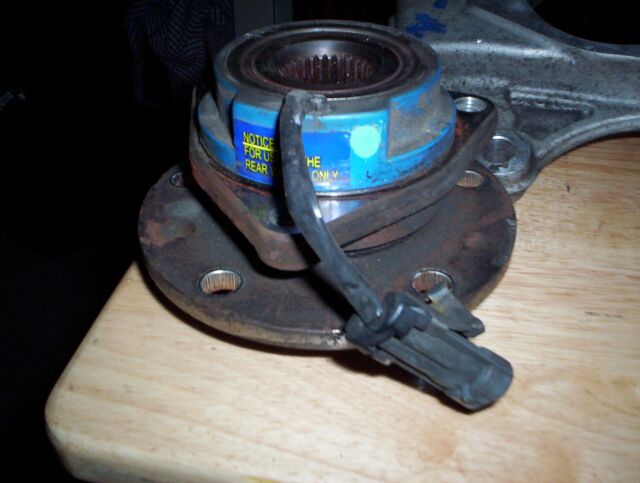

      I'm currently doing this swap on a 87 GT using 86 front calipers and 88-96 rear calipers. I'm curious how you managed to get a 88vette rotor to fit on the rear without using a spacer behind the rotor? I had to make a integrated spacer/consentric that moved the rotor .170" away from the bearing.
Without the spacer the rotor will hit the areas circled in yellow below-
Master Tuner Akimoto MSG #424, 05-30-2004 06:22 AM
      Brian are you going to make these kits for front and rear?
[This message has been edited by Master Tuner Akimoto (edited 05-30-2004).]
bubbajoexxx (bubbajoexx@sympatico.ca) MSG #425, 05-30-2004 03:04 PM
      if you use 88 rear rotors as per the part numbers I posted they do not need a spacer at all they do not hit any where as the rear rottors are shorter in the hat area
sluppy123
from your pics you are using front rotors on the rear. You should be using rears and your adapter would be only 5/16 thick rear rotors have 2 extra holes in them near the outer edge for ebrake ajustment when used with internal brum ebrake as in the pic provided
[This message has been edited by bubbajoexxx (edited 05-30-2004).]
sluppy123 MSG #426, 05-30-2004 09:07 PM
      I now understand why i needed a spacer, I chose to use front rotors on all four corners.
Regardless if it's a front or rear vette rotor the thickness of the adapter does not matter.
Also a note to anyone using the 88+ rear calipers, I don't see any way of using the stock e-brake cables, they are too short. I'm having to make custom cables.
[This message has been edited by sluppy123 (edited 05-31-2004).]
bubbajoexxx (bubbajoexx@sympatico.ca) MSG #427, 05-30-2004 11:12 PM
      the caliper bracket you see on my rotor is an 88 bracket and it is the same one you use to hold your caliper on as the 84 to 87 brackets are nolonger avalable from gm you have to use the 88 one on the rear

bubbajoexxx (bubbajoexx@sympatico.ca) MSG #429, 05-31-2004 04:28 PM
      in this pic you can see I have stretched all of the areo and trim parts but the rocker cover still looking fo spair pieces to make them up

      started the install here are some pics
riley MSG #465, 07-12-2004 02:24 AM
      that is absolutely amazing!!!!!!!!!
TaurusThug (roadconephoto@gmail.com) MSG #466, 07-12-2004 10:48 AM
      what kinda hp are you expecting from that motor w/ it being carbed??? 350-400???
[This message has been edited by TaurusThug (edited 11-04-2004).]
ToonTownfiero MSG #467, 07-12-2004 12:37 PM
      Keep up the ausome work. Looks good to me.
mrfixit58 (rlumsden@tampabay.rr.com) MSG #468, 07-12-2004 01:26 PM
That's the same place I put mine. Looks great.

3.8 SC MSG #495, 08-06-2004 09:40 AM
      I went to your website to read some more about your Fiero. Wow, you have a lot of other things going on there as well. I tried to E-mail you, but I kept getting an invalid E-mail address message.
I am really interested in your brakes and hubs upgrades. I was wanting to know what year the Pontiac 6000 uprights and S-10 hubs are from?
Also what bearing seal did you use? Were any mods done to get the two parts to fit together?
Keep up the good work,
Don
bubbajoexxx (bubbajoexx@sympatico.ca) MSG #496, 08-06-2004 12:57 PM
      3.8 SC
will check the email address may still be the old one will change it

bubbajoexxx (bubbajoexx@sympatico.ca) MSG #504, 09-05-2004 03:55 PM
      thanks to Bobert and Jim the rads are almost complete here are some pics
as ypou can see in the pics the rad air outlets are cut into the front of the wheel wells
bubbajoexxx (bubbajoexx@sympatico.ca) MSG #505, 09-10-2004 07:53 PM
here are the pics of the finished cooling system dual rads
in series dual fans and hiden from site
bubbajoexxx (bubbajoexx@sympatico.ca) MSG #506, 09-11-2004 05:28 PM
      I need your hounest opinion on this setup for the rear
topcat (tconey01@att.net) MSG #507, 09-11-2004 05:36 PM
      I personally like it without the hatch-wagon type of rear. The enlongated rear decklid makes it look better. I would say get rid of the luggage rack, and either go slick, or with a spoiler. Maybe someone can photoshop it
[This message has been edited by topcat (edited 09-11-2004).]
bubbajoexxx (bubbajoexx@sympatico.ca) MSG #508, 09-11-2004 05:45 PM
      rack will be removed so I can put the stock wing back on
doublec4 (doublec4@hotmail.com) MSG #509, 09-11-2004 07:10 PM
      To be honest, I never liked the hatch. It just doesn't look like it belongs. I like the elongated decklid best. If you want to take some pictures with the decklid on and get the whole car in it, I'll photoshop some stuff.
TaurusThug (roadconephoto@gmail.com) MSG #510, 09-11-2004 09:47 PM
      what if you did a super long fastback??? im with the anti hatch people too.. but if you did just the decklid dont put a spoiler or anything... just leave it slick.
Will (william.lucke@gmail.com) MSG #511, 09-11-2004 09:50 PM
      Either elongated notchie or build a stretched fastback clip for it. I don't like the hatch look either.
Jake_Dragon MSG #512, 09-11-2004 10:03 PM
      That would look killer with a Diablo kit on it

bubbajoexxx (bubbajoexx@sympatico.ca) MSG #587, 09-22-2004 01:03 PM
here is a few pics of why the rear can not be shortend
Patrick (mnofony@yahoo.com) MSG #588, 09-22-2004 04:05 PM
You do nice work, BubbaJoe. Definitely not a hack job!
Jake_Dragon MSG #589, 09-22-2004 05:41 PM
Thats a lot of stuff in there
bubbajoexxx (bubbajoexx@sympatico.ca) MSG #590, 09-22-2004 06:25 PM
      only what is nessesary and to keep the engine compartment clean of cluter .
All the nessesary electrical is all hiden and in the rear and will have a diamond plate cover over it all
the beam that runs between the shock towers is where all the electrical is run
[This message has been edited by bubbajoexxx (edited 09-22-2004).]

bubbajoexxx (bubbajoexx@sympatico.ca) MSG #596, 09-30-2004 02:23 PM
      Posted by Bobert using Bubba's computer.
Guess what ( I got to chop the top) !!! The wagonback is history.
Here is the proof !
The Chopped-up Top.

bubbajoexxx (bubbajoexx@sympatico.ca) MSG #619, 10-02-2004 06:49 PM
      well I have started to shape the roof pillers to fit the glass and have step by step pics to go along with it here you go
starting with sheet metal I formed molds to make the fiberglass fillers
test fit the peices to make sure they fit well
then covered them with a light glue then with plastic wrap so the fiberglass wont stick

bubbajoexxx (bubbajoexx@sympatico.ca) MSG #621, 10-02-2004 06:57 PM
      then removed the filler peices from the molds for trimming
now that i have them it is time to glass them in using a bonding agent then glassing them in solid
this is what the glass work looks like befor finishing
now retry the glass window to see how well it fits
screws will be removed in 24 hours so every thing cures up good and solid
[This message has been edited by bubbajoexxx (edited 10-02-2004).]

bubbajoexxx (bubbajoexx@sympatico.ca) MSG #624, 10-02-2004 07:26 PM
      Kohburn
here is a pic with the measurements of the glass on it
length of the glass without the deck is 44 inches

bubbajoexxx (bubbajoexx@sympatico.ca) MSG #626, 10-02-2004 07:40 PM
      jscott1
lotsa work but I think the finished glass rear will set off the looks of the stretch

mrfixit58 (rlumsden@tampabay.rr.com) MSG #629, 10-03-2004 07:33 AM
      WOW!!! That's going to look fantastic. But, please tell, how did you make the metal molds? From scratch?
Roy

bubbajoexxx (bubbajoexx@sympatico.ca) MSG #631, 10-03-2004 09:51 AM
      mrfixit58
one I had the shape draw out I used a sheat metal hammer and an anvil to pound out the metal to shape
lots of pounding and refitting till perfect . I'm a tin bandger by trade {sheat metal man} and many years of experiance

bubbajoexxx (bubbajoexx@sympatico.ca) MSG #664, 10-05-2004 03:59 PM
      closed in the glass work today to seal up the new window opening here are some of the pics
as you can see the whole area is being closed in with glass including where the body panel was cut
[This message has been edited by bubbajoexxx (edited 10-05-2004).]

bubbajoexxx (bubbajoexx@sympatico.ca) MSG #702, 10-09-2004 02:02 PM
      here is the pic of the finge mount for the glass and also the latest progress
deck lid so far now all that I have to do is bond it to the camaro hatch
as you can see the Camaro deck has had the uper skin removedup to 3 inches from the glass so the fiero deck can be sliped under the outer skin
to hold it in place for bonding
bubbajoexxx (bubbajoexx@sympatico.ca) MSG #703, 10-09-2004 02:10 PM
      here is a close up of where the deck is inserted under the camaro skin
bubbajoexxx (bubbajoexx@sympatico.ca) MSG #704, 10-09-2004 02:37 PM

      Cool. That looks like a 70s RX7 rear.

bubbajoexxx (bubbajoexx@sympatico.ca) MSG #719, 10-10-2004 05:34 PM
      as I said here are the latest pics deck all bonded in
once blended and painted it will look like it was made for the car

bubbajoexxx (bubbajoexx@sympatico.ca) MSG #737, 10-13-2004 01:53 PM
      hub swap so I can install the wheels
first of all I removed the brake caliper and rotor to get access to the old hub
so it can be removed
with the hub removed I installed the concentric ring for the new seal surface
now that the ring is pressed on I can install the larger corvair hub with the correct bolt circle
with the hub installed the rotor now sits 5/8 of an inch closer to the spindle witch mens my brake adapter must be 1/4
of an inch thick so off to the shed I got to make a new one .
With that done I installed the front wheels and they fit perfect and with the larger front bearing less chance of failure
and the wheel is more centered over the rear bearing so less stress on the front bearing.

mrfixit58 (rlumsden@tampabay.rr.com) MSG #746, 10-13-2004 04:00 PM
S10 bearings and pontiac 6000 uprights or I will have the S10 bearing hub remachined to fit the fiero bearing .
I have done the S10 6000 swap before and it works ok
So the S10 Bearing and the 6000 bearing are the same except for the flange/bolt pattern? Are the axle splines of the 6000 and the S10 the same? And, I assume, that the S10 bearing is from the front of a 4x4? What years?
This is good stuff. Thanks for sharing,
Roy
bubbajoexxx (bubbajoexx@sympatico.ca) MSG #747, 10-13-2004 05:26 PM
      the inside diamiter of the upright must be opened up about 20 thou for the bearing to fit and the flange has a round bolt hole that has to be notched to get access to the bolts to tighten them up and the S10 axle end will fit the end of a fiero manual axle

bubbajoexxx (bubbajoexx@sympatico.ca) MSG #752, 10-13-2004 11:23 PM
      here are a few of pics of the shreck (as my wife calls it) with the vette wheels 17X9.5 with 315x35x17 rubber the same width as 275 40 18's

Will (william.lucke@gmail.com) MSG #753, 10-14-2004 09:36 AM
here is the link to the rear setup
http://www.fortunecity.com/skyscraper/switch/67/id205.htm
here are a few of my options I have used
http://www.fortunecity.com/skyscraper/switch/67/id20.htm
So you did finally do the machining to make the bearing actually seat on the knuckle?

bubbajoexxx (bubbajoexx@sympatico.ca) MSG #757, 10-14-2004 08:46 PM
      the pics are to show that the tires will fit under the fiero with the coil overs as the stock spring interfer with tire size
I am hoping to have it done in the spring paint and all
bubbajoexxx (bubbajoexx@sympatico.ca) MSG #758, 10-14-2004 08:52 PM
      Will
the fit is so close that only a small amount needs to be removed the first ones I did I removed the extra material with sanding brums and it worked fine
now I going to se if I can reduce the size of the bearing surface to match the fiero bearing shells If so iI will go that rout

      Formula88
tire sizes dont mean much if they wont go under the car the above pics are just to show what will fit and what I know will go under the car as I have already done it

Will (william.lucke@gmail.com) MSG #762, 10-14-2004 10:00 PM
Will
When I first saw this on your website I got an S10 bearing to try, but it had a shoulder that prevented it from going into the A-body upright, as well as bolt pattern issues, IIRC. I didn't feel like doing the necessary machining to get it to go together. I don't believe in modifying wear parts like bearing cartridges.
I looked more closely at your website and one of the pictures you had up at the time showed quite clearly about 1/4" gap between the bearing and the upright. I was quite graveled that you called it a bolt together upgrade...
But if you're doing it right now, that's all gravy.
bubbajoexxx (bubbajoexx@sympatico.ca) MSG #763, 10-14-2004 10:44 PM
      Will
the first ones I did are still working fine on an old fiero I sold the owner has put over 40,000 miles on the setup with no problems the one I will be doing for the back will have the hub itself remachined to fit new bearings and fitted to a smaller bearing shell If possible if not I will rework the 6000 upright to fit the bearing and install a press in collar around the inner bore which will make it fit better than in a stock S10 upright for the bolts I bolt the bearing housing in from the front and drill out the stock threads and slot the holes .this moves the bolts closer to the housing and retains its strength moving them outward would weaken the housing
this is one of the pics from the site
[This message has been edited by bubbajoexxx (edited 10-14-2004).]
Will (william.lucke@gmail.com) MSG #764, 10-15-2004 09:34 AM
      I refuse to modify a wear part. I have visions of being stuck in the middle of the desert needing a wheel bearing that requires 2 hours of machine shop time before it can be installed.
I would be willing to modify the upright, however, but I'd rather just start from scratch...
bubbajoexxx (bubbajoexx@sympatico.ca) MSG #765, 10-15-2004 02:30 PM
      Will
thats what I do is retrofit the upright to fit the bearing I will see if it is possible to move the holes in the upright to make the bearing a bolt in without slotting the holes
and post my results as uprights are cheep from the bone yard there are plentifull

      well I picked up the parts for the rear hub swap today and have remeasured all the components and it is possible to mount the S10 bearing without changws to the bearing all than needs to be done is rebore the upright to fit the bearing and put a bearing spacer in I have the diagram for the spacer done and once machined I will do the test fit and then post pics of the unit
bubbajoexxx (bubbajoexx@sympatico.ca) MSG #773, 10-17-2004 05:07 PM
      here is some of the info needed for the rear hub change
fig. A: you need to rebore the inside diameter from 3.55 to 3.615 to a depth of 1,085 inches
fig. B: the bolts holes need to be moved over .020 inches to bolt the new hub in
as you can see in this diagram the hole are only off a small amout
as I am using the Vette brakes in the rear I need to remove these ears in yellow for the caliper brackets to be installed
the diagram for the bearing filler is done and will post it separetly

bubbajoexxx (bubbajoexx@sympatico.ca) MSG #779, 10-20-2004 02:28 PM
      p8ntman442
as I said earlier in the post this car in the pic has over a 20 inch stretch
and is not what I am doing .My stretch was done to acomidate the engine trans axle I am using
as the th 425 will not give you a true mid engine and is auto when I preffer a stick
bubbajoexxx (bubbajoexx@sympatico.ca) MSG #780, 10-20-2004 02:31 PM
      mrfixit58
83 to 92 are all the same the 92 have a abs ring but is easy to remove but are the same diamention
83 to 89 have no ring so are cheeper to buy

bubbajoexxx (bubbajoexx@sympatico.ca) MSG #784, 10-24-2004 04:03 PM
      got the uprights back yesterday with the rebore done and the holes slotted and the bearings fit without being reworked hope to have the spacers done this week and will start removing the old setup for test fitting of the brakes and wheels tomorrow
[This message has been edited by bubbajoexxx (edited 10-24-2004).]

bubbajoexxx (bubbajoexx@sympatico.ca) MSG #793, 10-26-2004 02:36 PM
there on the car still more to do though to go with the 9.5 rim I have to move the strut inward 1/4 inch and will do that with the new struts and coil overs

OH10fiero (scottfiero27@aol.com) MSG #810, 10-29-2004 12:45 PM
      Why is this on page 4?!?!?! Heres a little bump to put this thread where it belongs.
Sacred (sacred@comcast.net) MSG #811, 10-29-2004 03:46 PM
      Any updates?
bubbajoexxx (bubbajoexx@sympatico.ca) MSG #812, 10-29-2004 07:19 PM
      the rear hubs are completed and will be back at the body work soon will post pics tomorrow as it is raining here and pics wont look to good with a wet camera

      the roof section was boned in today and sloped to match the new roof line of the glass hatch here are the pics
the blue gray stuff is the bonding agent for SMC pannels and takes 3 to 6 hours to bond securly
so I will glass it in tomorrow once the bonding is fully cured

      here is the roof section properly glassed back in
the best way to glass SMC is to ruff the surface with a wire wheel so as to get deap gouges for the glass to bond to as in the pics
now lay the glass in onl as needed to fill the area that is preped as glass wont stick well to a smooth surface
when sanded there is very little filler needed to smooth the area in as seen here

      time to up the anti again as I have started to build the tube cradle for the vette suspension here are some start pics
asyou can see the attaching points for the a arms fully encircle the frame tubes for max strenght, not gut welded on as in this pic
you would have to sever a tube completely to brake one of my brackets of
these are the uprights that bolt to the lower controll arms this is a un equal length A arm setup short uppers long lowers
mrfixit58 (rlumsden@tampabay.rr.com) MSG #928, 12-03-2004 03:25 PM

shop_rat45 (kristopherjune@yahoo.com) MSG #932, 12-03-2004 05:35 PM
      What size is that tube? Wall thickness? Are you going to bend it? If so, how? This is turning out to be one heck of a project. Where in Canada are you at? I gotta come see this thing when it's done!! Very amazing work.
Kris
FieroMikeTDC MSG #933, 12-03-2004 05:44 PM
      WOW! That thing is a monster.
bubbajoexxx (bubbajoexx@sympatico.ca) MSG #934, 12-03-2004 05:50 PM
      shop_rat45
1 3/4 by .125 wall the front tube will be curved at each end where it goes into the body mount and cross braced at the suspension points the rear will curve up to the frame then braced back to the center of the a arm attaching points with 1 1/4 inch .125 wall tubing

What are you going to use to bend it? Some sort of tube bender? That's the size I want to use for my control arms, but I'm still debating on how to bend them. Also, where are you getting the tube from? Locally? Thanks.
Kris

bubbajoexxx (bubbajoexx@sympatico.ca) MSG #937, 12-03-2004 07:13 PM
      shop_rat45
the tubing I get from the Metal Super Market here in Toronto and I have control arm tubing and it is not regular tubing it is a special steel alloy
that will resist twisting and I have access to a pipe bender from the Guy,s at RIO automotive and welding here in TO but you can buy pipe benders cheep from Princes Auto in Canada 149 .00 dollars CD from there web site when on sale . I will post a pic of the steel for control arms tomorrow .
bubbajoexxx (bubbajoexx@sympatico.ca) MSG #938, 12-03-2004 07:15 PM
